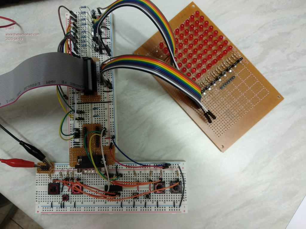

Latest update:
Well it didn't take long to knock up an "NES controller" on solderless breadboard and it worked first time!
Using 4k7 pull-ups throughout:
- It works with open collector and 5V Vcc, CLOCK and LATCH
- It works with open collector 3.3V Vcc, CLOCK and LATCH
- It works with normal digital output 3.3V Vcc, CLOCK and LATCH
I just hope I didn't fritz anything on my MM when I briefly had a 5V DATA line connected to a non-5V tolerant pin ... seems to be OK.
Glamour shot for posterity:
(Note that in the above the DB9 isn't connected, but its breakout board is connecting the lines across the central divide.)
