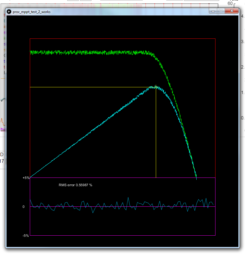

Mike, the above code was just a start. It does not work as a matter of fact.
proc_mppt_test_2_works.zip
does work and works well. n/N alter the noise, k/K moves the "knee" of the current curve left or right.
In the case of the buck converter, PWM width is directly proportional to the ratio of input and output voltages. With the mppt controller I am designing, pwm width is proportional to the "operating voltage" of the solar panel, i.e. input voltage.
I have found that with the low impedence wiring I used in the 2 boards, I saw only very small changes in PWM width when I alter the current that is output.
I find pwm width to be a close analog to input voltage.
The code determines input voltage from the pwm width. I use 800 units of pwm width, 1 unit to 800 units wide. I map this 1 to 800 units to 0 to 50V (Vmax in the code)
I do not care about output voltage or battery charging in this test code.
I just want to see a peak search function work. And still work with noise.
Give the attached file a go and see what you see.
Now I have functioning perturb and observe code, and I have improved it to be capable of working well with a noisy signal, I am ready to start on the controller firmware.

here is a video of the mppt tracking, running the program contained in the zip file above
I change the knee position of the current curve, which of course alters the location of the power peak.
It works nicely. With less noise it finds the peak faster.

0.6% RMS tracking error. Not too bad with this amount of noise.

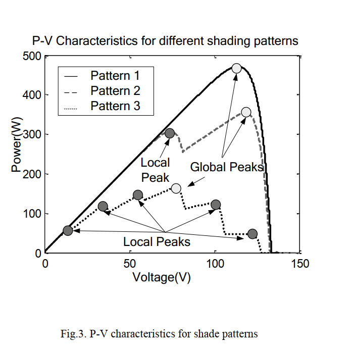

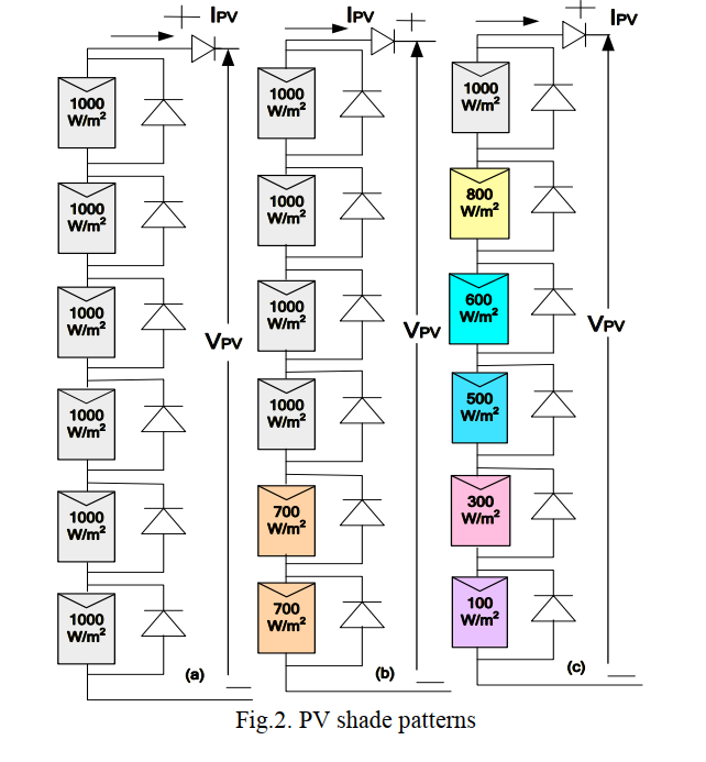

The reason I will incorporate the periodic max. power scan is due to shading of parts of an array can cause multiple power peaks. My MPPT code will not find always the maximum peak among a few, it will just track to the top of the first one it sees.
the paper from here shows some potential situations.
and here are the P-V curves for the above 3 examples

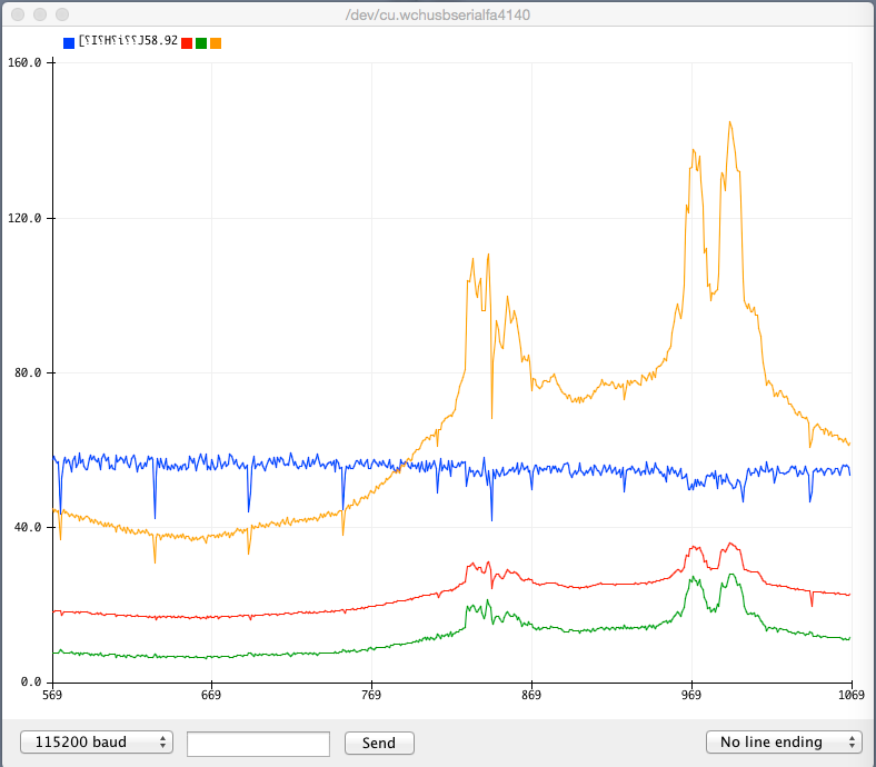

Today I have connected board#2 to the East facing solar array.
Weather is rain and some bright clouds but mainly rain.
The code is the usual, a periodic scan for max power point, then run for a minute tracking around that point.
here is the pwm during tracking, scan then back to tracking.
https://youtu.be/Gh8SCeYtEPk
Below is a graph of a certain time this morning when the sun nearly broke through.
Peak power was about 1500W.
Power INPUT is Orange, divided by 10
Blue is Volts IN
Red is Amps OUT
Green is Amps IN
The x axis is 500 points wide, 1 second per point.
You can see a periodic short dip in output power. This is when the max power scan occurs. It is satisfying to see that after max power is determined, it is quite close to the power that was tracked just prior to the scan. It means the MPPT tracking is working well.
The bucket of water (that holds the 1 Ohm load resistor) has nearly come to the boil
https://youtu.be/H2wleS350hA
Edited 2020-05-02 13:54 by poida

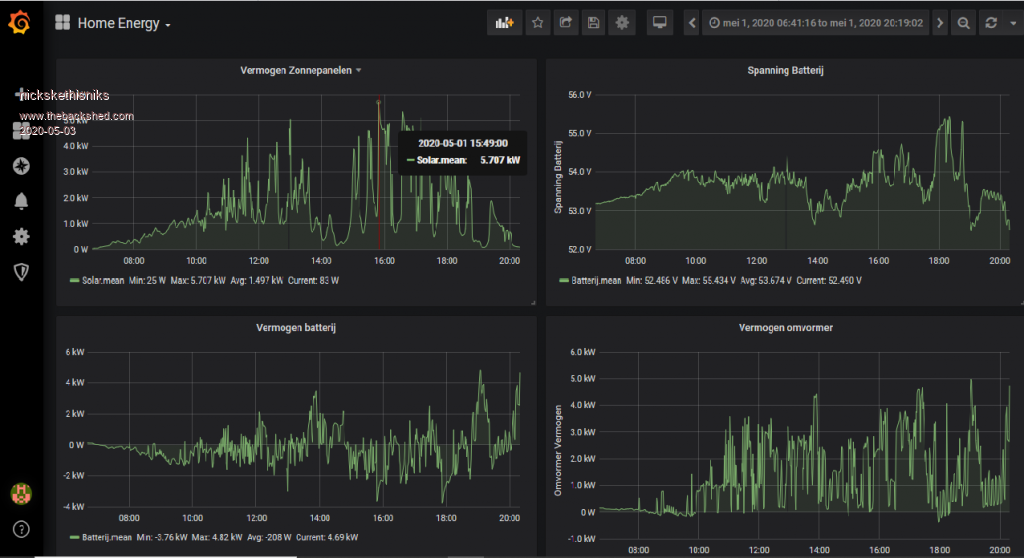

I use an Re-1215, it should be one voltage, 12V is enough, even 10V will do. I have a s*load of certain components that are not allways the right fit, but it should safe me money, not allways. Btw, it has the same footprint then for example a recom R05B15 and it has - an +15V outputs. So you guys had a bad day huhm? I made a record with that powerpcb yesterday:
I don't consume that much energy btw, but I activate a heating element in my heat storage tank (3kW) as soon the battery voltage is 54V. The heat is used to warm the bathroom and the small office of my wife, they both have floorheating.
So 5700W! that's more then 100Amps pumping in the battery (load)!
(btw there is a small gridtie inverter coupled to the ozz inverter)
Edited 2020-05-03 05:22 by nickskethisniks
