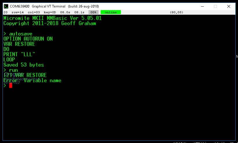

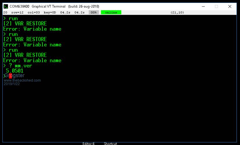

PROCEDURE: (With an E28 module)
1) Load 5.0501 in PIC32PROG
2) Press SELECT button for programmer mode
3) Program in 5.0501 HEX to E28
4) Connect to E28 using GFXterm
5) Type AUTOSAVE and press enter
6) Paste test code, then CTRL-Z
7) RUN
ERROR!
Tinker with this idea a bit, then issue VAR CLEAR, then run again - All L's.
I will now load an earlier version of MMBASIC and test if that works as expected. I think it actually will, based on other comment thus far.
EDIT: CONFIRMED!
If I flash 5.0408 into the same E28, use exactly the same procedure, and run the code - no error. This is intensely interesting. I think we do have a bug here in the newer versions of MMBASIC, when you try to VAR RESTORE on a fresh install. It's obscure, because it only ever seems to be a problem on a CLEAN INSTALL of MMBASIC, and then you run the code the first time. Subsequent running of the code will NOT show this issue. But if you are using a full HEX consisting of the MMBASIC interpreter, your own code, and previously saved variables, I can see this being a problem.Edited by Grogster 2019-01-23
