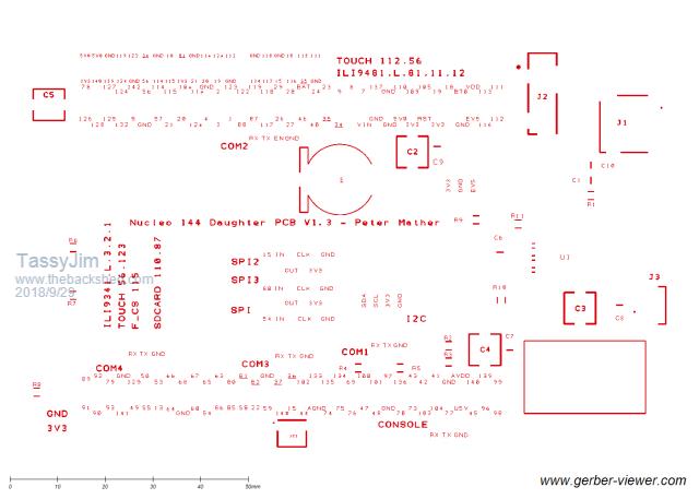

Can anyone tell me what pins are used for T_IRQ and T_CS on the v1.3 backpack boards?
They are listed as configurable in the manual, I assume they are set for the backpack boards?
Mike.
Posted: 02:52am 29 Sep 2018
My version 1.0 board has
OPTION TOUCH 56, 123
I expect the later boards are the same.
Edit: it will depend on the display you are using.
Edited by TassyJim 2018-09-30

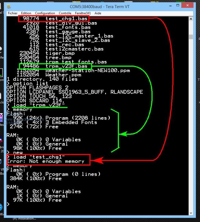

Yes I use button "load and run" in mmedit menu
If I use "load" function in mmbasic (load "test_chg1"), it say "not enough memory"

I put here my screen save. You can see that the ultime block is "loaded" many times befor it stop

here you can see my teraterm screen
I begin to understand the problem
1 - ram memory free is 98k. That mean that you can't load file more than 98k byte long (have-you an other way to load??)
2 - option flash change only flash memory not ram
3 - when you write "98k" that mean 98 x 1024 byte (100352 bytes), but file 98774 bytes can't be loaded, why?? Edited by goc30 2018-10-01

@goc30
I see that you are using
OPTION LCDPANEL
SSD1963_5_BUFF
That is where your memory has gone to.
  Quote  Selects 16-bit bus operation of the 5” and 7” SSD1963 displays
using a memory framebuffer for improved performance. This
uses 400K of memory leaving 98K for user programs
Without the video buffer
> LOAD "temp.bas"
Error: Not enough memory for Cfunction
> option flashpages 2
> LOAD "temp.bas"
> memory
Flash:
136K (35%) Program (3992 lines)
248K (65%) Free
RAM:
0K ( 0%) 0 Variables
0K ( 0%) General
498K (100%) Free
Plenty of flash and RAM available and a large program loaded without any problems.
Posts: 12085
Posted: 07:40am 30 Sep 2018
  Quote  I begin to understand the problem
As Jim says the issue is the driver you are using. Unless you specifically need the buffered driver use SSD1963_n_16
If you really need this driver then disable it, load the program and then re-enable it. That way all the RAM will be available for program load.
The code reserves some RAM for housekeeeping so you can never use all the RAM available during program load
