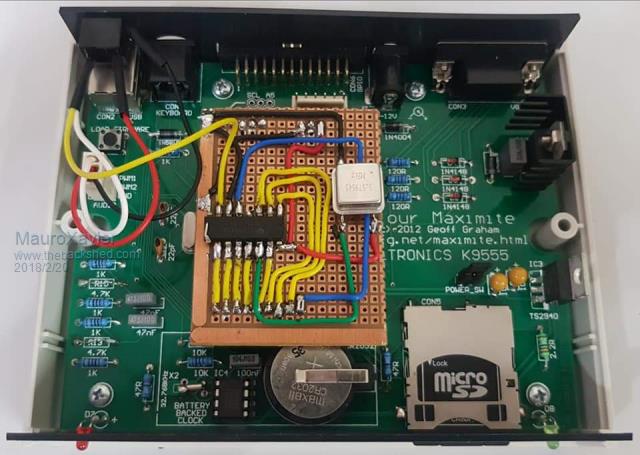

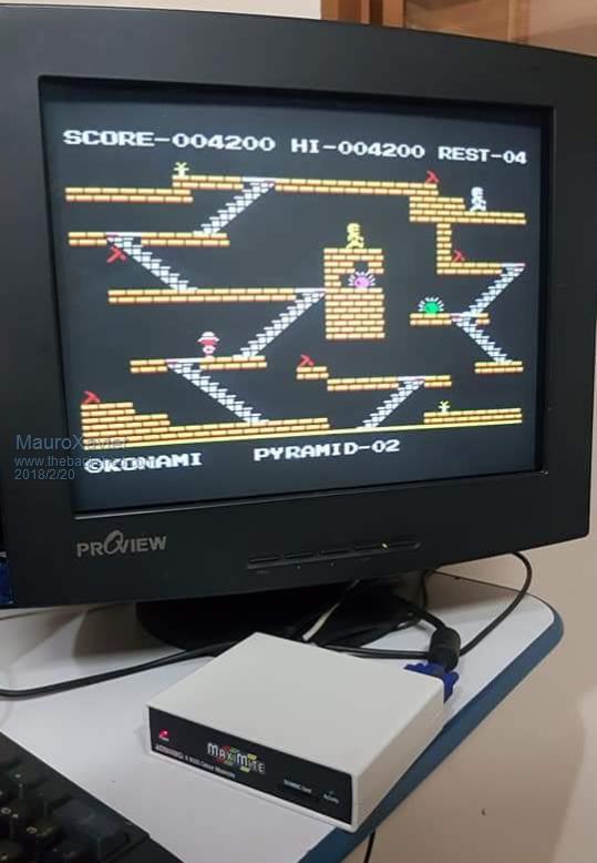

Some images of my projects in CMM:
First prototype of PSG board:
MSX King's Valley sprites test:
Soon I will upload some vídeos.

As I promised, here is a new video showing the Colour Maximite playing some VGM files using a hardware PSG SN76489:
https://youtu.be/iSozlDADcbM Edited by MauroXavier 2018-02-27

That is brilliant. You have taken the Colour Maximite to a new level.
Posts: 10081
Posted: 10:14pm 25 Feb 2018
The sound chip is cheap - 27c each....
Pack of 5 from AliExpress in DIL
No doubt a clone at that price. I could not find this chip in stock at any of my primary suppliers - DigiKey, Mouser or Element-14. Not stocked at any of those component houses. Perhaps Mario will say where he got his ones from.
Perhaps an optional extra for the new beast Geoff?
...but then, we are off into multi-chip designs again, so perhaps not!

Soon I will upload a file with all sources and schematics, and It's very easy to make this "gamecard". In all games I made I put three options:
- PWM Sound only (sounds like ZX Spectrum 48k)
- MOD Sound (Amiga style SFX, but I consider this option a little insecure because the relative small flash cycle of the chip)
- PSG Gamecard: Remember something between Master System and Coleco Vision.
I can mix them, for example, MOD Music with PSG SFX and vice versa.
Soon I will show the new version of Boulder Dash with this options and a new game that is a mix between Laser Gates (Atari 800) and Scramble, with the three options of sound too and a smooth scroll. Obviously, all them are betas and can be considered by now a tech demos for CMM.
With this I only want to share a new way to make games in CMM, and who knows, MMX.
