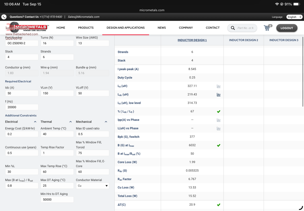

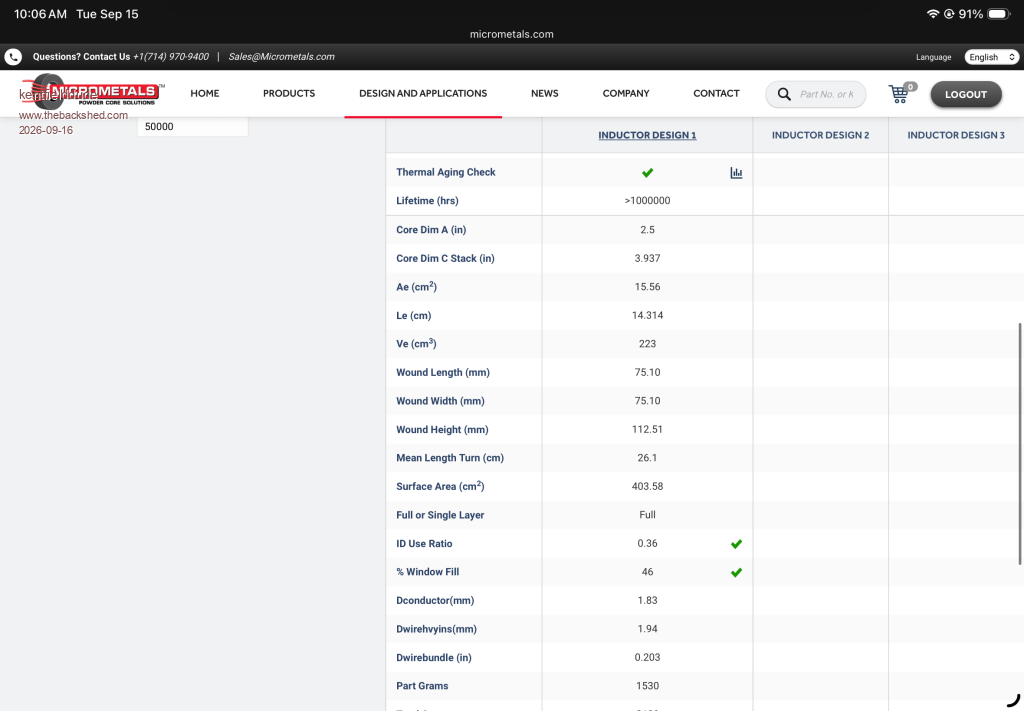

Posted: 05:07pm 15 Sep 2026
That kool mu core would work but it requires quite a bit of copper to get the copper losses down and it’s quite. A bit of turns. I may purchase another core and stack two of them. With one core you’re loosing an lot of inductance at 50 amps because it’s operating on the tail of the curve.
I was looking at micro metals and trying different configurations.
I found a really good potential design.
It uses a stack of 4  OC-250090-2
16 turns
If they aren’t too expensive I’m thinking about trying this design.
Edited 2026-09-16 03:09 by kentfielddude

Would you use 4 strands of 4mm2 or 6mm2 wire to wind the core?  I see a lot of big commercial designs go for that to make winding easier?  Also what is limiting the frequency?  I got very high losses at high frequencies.
Persistence is the key
kentfielddude
Joined: 09/05/2019
Posts: 121
Posted: 12:43pm 16 Sep 2026
  SYM-1 said  Would you use 4 strands of 4mm2 or 6mm2 wire to wind the core?  I see a lot of big commercial designs go for that to make winding easier?  Also what is limiting the frequency?  I got very high losses at high frequencies.
I'm going to use multiple strands of magnet wire because that's what I have on hand.
Increasing the frequency increases your switching losses; i.e., your MOSFETs get hotter.
Core loss depends on what material your core is made of. Sendust is only good below 100 kHz. Above 100 kHz, eddy currents start to dominate and cause a lot of core loss.
It appears that all Micrometals powder cores are made in China. I believe Magnetics Inc. cores are also made in China. I was able to find the same cores on Alibaba for 1/6 of the price. I ordered 8 pieces of KS-520-060A.
Edited 2026-09-17 02:52 by kentfielddude
