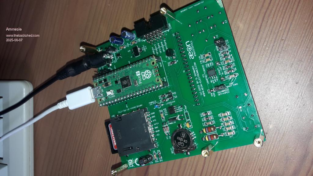

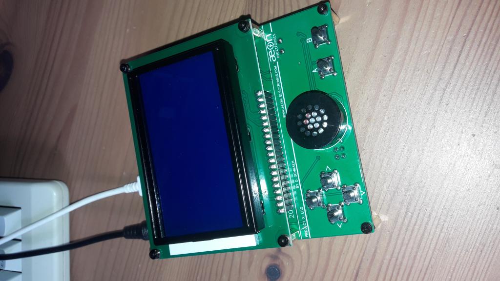

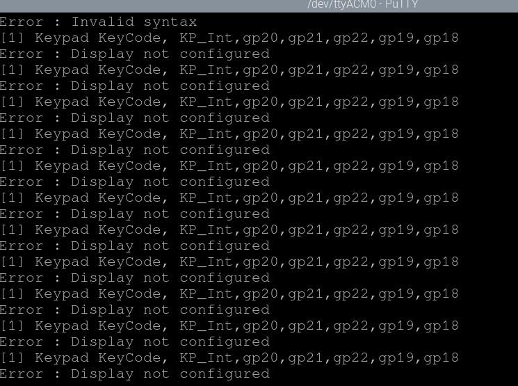

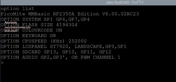

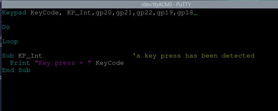

Hello, I think I found a bug...
can anyone confirm this? I was trying the Keypad feature, see for yourself:
I tried also tried a different syntax, always the same. I am using as you can see a 128x64 LCD...
Because of the "display error" in Putty I also tried to do something like:
option display 24,80
Problem persists. I have a 2 row by 3 column keypad.. I don't know what I am doing wrong.
row1 is: GP20
row2 is: GP21
col1 is: GP22
col2 is: GP19
col3 is: GP18
Greetings
Daniel

Obviously the error isn't right but manual page 55
  Quote  The PicoMite firmware supports either a 4x3 keypad or a 4x4 keypad

Hello Peter,
thank you a lot for your reply! Ahh this is my bad. My PCB is already designed for an 2 by 3 row Keypad... Hm.. Ok. Then I have to do a redesign. I assumed, that it would be no problem to allow a smaller keypad. Sorry my bad
Or is there a work-around possible?
I have some pins left, that I initially wanted to use for GPIO...
Greetings

If you have two unassigned pins then just include these in the keypad command and your PCB will work fine. Otherwise just run the scan in a timed Basic interrupt
