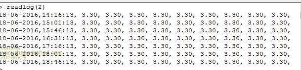

I have loaded 9 readings as well as the time and date one reading every 5 minutes to a total of 50 bytes ,this is what I get when I readlog()
are you saying that all of these are on one or more pages page.Edited by centrex 2016-06-19

  Quote  are you saying that all of these are on one or more pages page.
I'm saying each ascii character in a string uses 1 byte + an overhead of 1 byte for each string logged. The logging code takes care of everything else.

It is when you do a readlog() that puzzles me because it prints out on separate lines (see the screen dump a couple of posts ago) I am expecting one long comma delimited file or at least a file that is 256 bytes long followed by another similar file.
More reading of how the readlog() works required

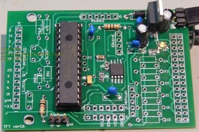

Give it a couple of weeks for the slow boat from China to arrive and I will have PCB that could do what you want.
28 pin mite,ILI9341 interface, a position for the memory chip that started these pages as well as a number of other features.
I know it has smd but they are of a size that are reasonably easy to solder, most of it is through hole.

Anyone looking for a 28 pin pic that will interface with the ILI9341 touch lcd module, has pads for the Windbond memory chip featured at the top of these pages that runs with Matherp's cfunctions for data logging, it will also interface with the sd card on the lcd again running Matherps cfunctions, provision for Pickit3, I2C and TassyJim and friends wrapper (mmflash)to allow programming of other Pic chips.
I have a few of these left over $2 per board plus postage.
PM me.
