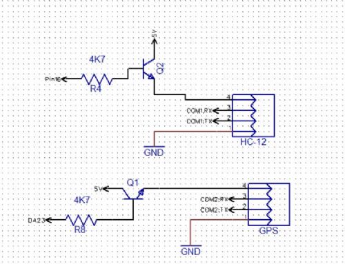

ok I've gone back to the original npn transistors
I know this will work, even with a bit of a voltage drop if fed from the 4.7 or 5v rail there will be plenty of voltage to power the modules as each one works from anything between 2.6-5.5V
When the pin goes high the transistor conducts and will let the voltage through to the module, simple transistor switch!

  lew247 said   ok I've gone back to the original npn transistors
I think you are mistaken there as well...
You are trying to get say 4.5V to your GPS module... Assuming you could get 4.5v there the voltage at the base cannot go above 3v3 so the transistor would be turned OFF hence you couldn't get 4.5V to the GPS...
Basically the concept is wrong..
Going back to the PNP transistor circuit.. If you put a 10k bias resistor from Base to emitter you would get the following.
Set the mite pin an OUTPUT and set it LOW and the transistor will turn on allowing power to the GPS module.
Set the mite pin to an INPUT allows the 10k resistor to pull the base to 5V turning the transistor OFF..
Now that is OK if you use a 5V tolerant mite pin.. but if not you will need a schotkey protection diode (anode to the mite pin and cathode to 3v3)

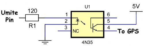

Probably the easiest way is to use an opto isolator as in this circuit
They are fairly cheap and will only draw power when ON (the LED side is set for about 10mA.)

How much current can a opto isolator typically switch.

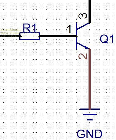

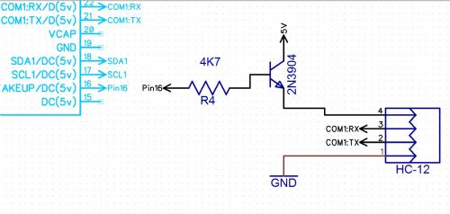

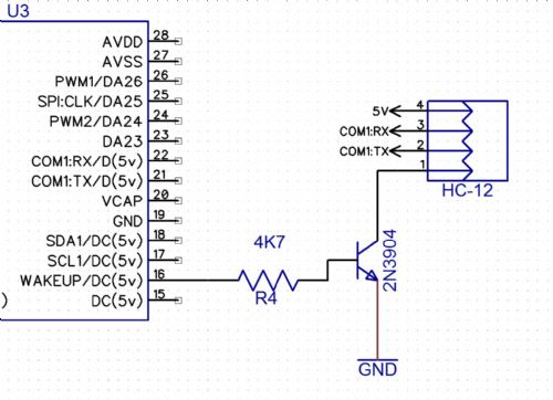

Look at the diagram below
The module itself brings the transistor to ground

Thinking about it a bit more.... if switching to ground that also means the GPS module has to be isolated, mounting screws might be grounded and give a path for the current.... hmmm. Looks like the opto is the easiest option.

Posted: 04:01am 24 Mar 2016
Lew,
If you look at your diagram (the one in 5V line) you can see that the Maximum voltage (with respect to GND) that can appear at the BASE is 3v3. Giving a best case of 0.6V drop across the b-e junction would mean the maximum output voltage that could appear is 3.3-0.6 or 2.7V.. But in practice I think you will find that the GPS module would not power up.
The 2nd diagram with the transistor in the GND line is technically feasible but, as MB has stated, you would have to isolate the GND of the module from anything else and you have the problem of `bleed through the TX and RX lines when the transistor is OFF.. It `may' work OK, well it would probably work as a GPS solution but will it still draw more current than you wish to draw when it is OFF??
If you have a module why not try it and do some current measurements?
Do you know the max current draw of the GPS? Even the OPTO (4N35) I drew may not work as it (the datasheet is a bit confusing to me) seems to have a max `operating' current of 50mA but you would need to feed the LED side with about the same which the uMite will not do (max about 15mA)...
Back to the drawing board me-thinks.. best the dual transistor drive circuit Hank suggested.. or a miniature relay or solid state relay..

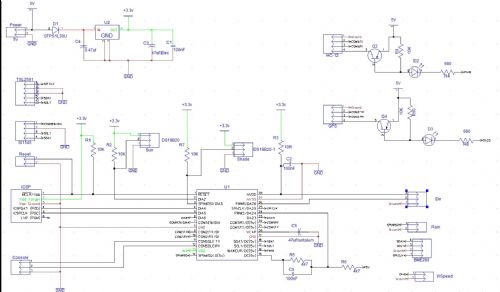

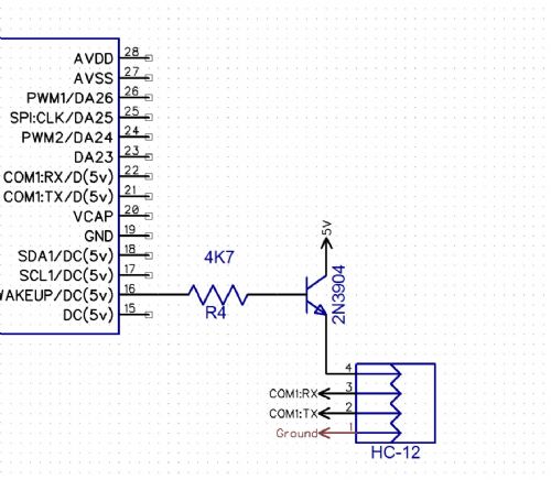

Due to problems with the switching of the transistor I've had to modify the circuit
I'm informed this should work perfectly now
Edited by lew247 2016-03-25

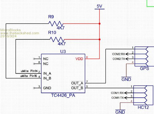

What about using this:
http://ww1.microchip.com/downloads/en/devicedoc/21422d.pdf
It has two channels, so only one DIP-8 chip is needed.
You would need the inverting TC4426.
Pull the input up to 5v and use a 5v tolerant uMite pin to put a LOW on the input of the TC4426.

It's a driver for a fet so I'd need to add 2 fet's as well

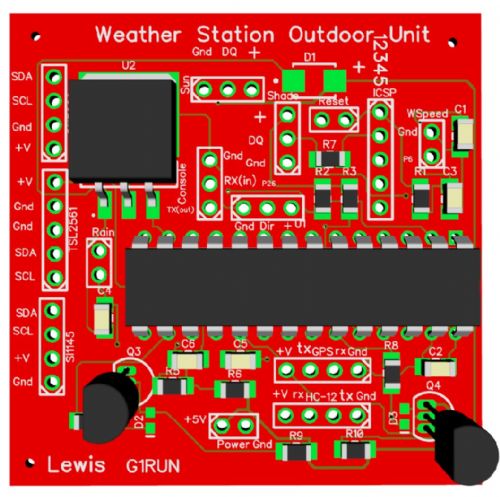

BTW MicroBlocks (or anyone) How do I change the setting on Diptrace so I can see the traces on the bottom of the board (or the top again afterwards) ?

No the FETS are part of the chip. It is a complete circuit to get from a logic level to an output 'switch' that can have more current.
Only one resistor per channel needed.
I think this would be how to use them.
I don't have the part so i can not test. They look interesting so i have ordered a few.
As for the layers in DipTrace:
Press 1 for top, 2 for bottom.
Or use the little listbox in the toolbar to choose the layer.
If you not see that listbox, press F6 to enable/disabled the route toolbar.
You can also check which toolbars are visible under the menu View->Toolbars

MicroBlocks is the part you used on your board, the screw terminals part of the standard Diptrace package?
I've been looking but cant find it
Posted: 12:45pm 24 Mar 2016
Hi Lew,
I hate being the Harbinger of DOOM
But..... I really do not understand that circuit at all, the way I see it the Emitter-Base junction will work as a diode and effectively be permanently supplying power to the LED/load.. Unless someone can show me the error behind my thinking and explain how that circuit works...
I have a simple Idea I will post in a future message..
I am not entirely dismissing that circuit as I honestly cannot understand how it would work and my transistor theory is rusty at best.
