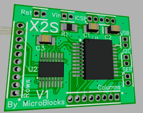

Ok here is my progress so far.
I made it into a small module that can be added to any mcu. I left out all the connectors and power supply stuff as that is often already available.
The pcb is 23x18mm. No software yet as i am waiting for the DIP parts to arrive.
Schematic:
2015-08-24_202441_BBM_X2S.pdf
pcb:
The BBM in the filename stands for something that i am working on for some time now. Still have a few problems to solve before i can announce it. :)
Edited by TZAdvantage 2015-08-25

A question re the use of the 4017.
Don't you need diodes to prevent shorting two of the outputs when two keys are pressed?
Posted: 01:38pm 24 Aug 2015
Jim,
Good catch!
I had them in my schematic before, but decided to take them out. They limit the possibilities.
This module can be used for different purposes also. Like an Led matrix. Or a mix of switches and leds.
Or maybe just as single outputs. Having the diodes mounted would limit its use, so i opted for having those on the pcb where this module will be put on.
I also considered using a 1-16 analog multiplexer. Then only one output is active and all the others are in high impedance. This would need 4 pins of the PIC. There are also 1-8 multiplexers that need 3 bits but then i am one row short.Using those would not need diodes.
I not rule out the 1-16 if more keys are needed. With this PIC i not have enough pins unless i sacrifice either I2C/Serial or USB.
I also could use a 4 bit binary counter and connect the outputs to the input of a 1-16 multiplexer. That would also require only 2 pins from the pic. Hmm.... a 16x8 matrix. I will have to think about that a bit. I'll get some chips and test that too.

Well you do have one more pin if you use #config MCLRE_OFF, then MCLR is available as RA3.
Chris
