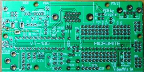

UPDATE: Just got emailed the photos of the finished boards.
Shenzhen seem pretty efficient with the whole process. I also like their prices, and the photos they send of the boards before they ship them to you - a nice touch.
EDIT: Looking closely at the photos, it would seem that the silkscreen registration is slightly to the left of where it should be, but I guess that does not really matter - the copper etch looks fine. The boards are so cheap, I suppose something has to give! Edited by Grogster 2014-12-03

Silkscreen registration is out a little. My 1st board(Expandamite - the SS one) was fine.
Registration is out by about 1mm across the board, on all boards.
I don't REALLY care that much - I am just being picky.

None of mine show any registration problem, I agree it isnt a huge problem but 1mm is quite a lot.

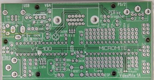

Load your gerbers into this Online Gerber Viewer to see if it is actually your artwork
Posted: 10:05pm 08 Dec 2014
Checked with Online Viewer, registration is perfect in the gerbers, but it is out on the actual board.
Note how the outline for the headers is off to the left, and also slighly lower then it should be.

EDIT: Here is a link to a big image. You can't really see the issue with the photo above, as the forum software is squeezing the photo. If you follow the link, you will get a nice big image, and you can clearly see how the registration is off.
No biggie though. Etch is fine, soldermask is fine. The silkscreen is more cosmetic then functional.

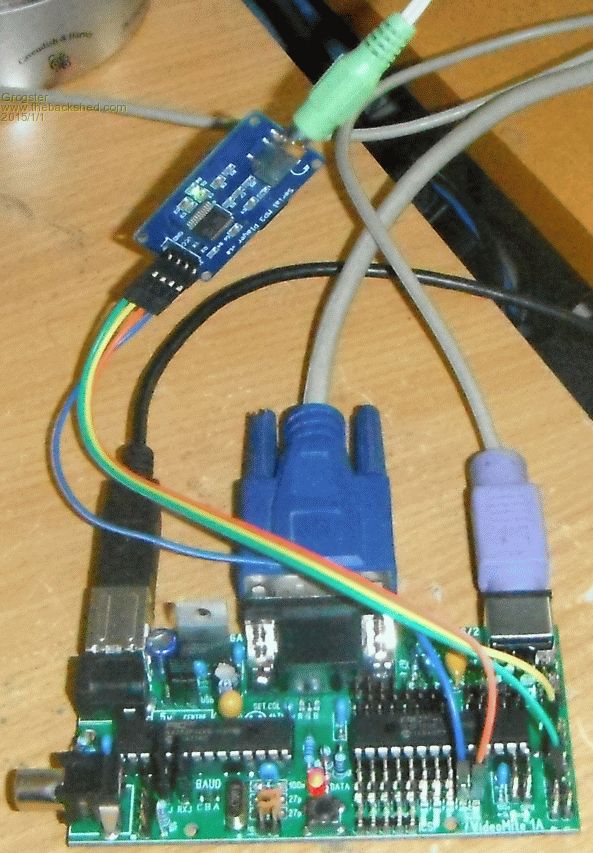

As Geoff has assembled his VideoMite PCB, and I have sent off a few to other members here, I thought I should assemble one myself, as I designed the bloody thing!
This shot is of it talking to one of those $6 MP3 player modules from eBay.
These MP3 modules are really impressive for the price and size, and sound great.
The only thing they lack, is a BUSY line. The chip itself does have a BUSY pin, but the module designers have not routed that out to a user pin for some reason. If I am VERY careful, I might be able to solder a hair-thin wire to pin 10 of the SSOP and bring it out for connection - then seal it with a blob of glue or something, to stop it breaking off. I do have a Goot rework station, so this may be a job for it.
