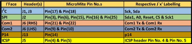

Hi
Com2 is unused so you can use those pins for I/O (Pins 9 and 10)
You would connect your laptop to the console port via a TTL serial adapter
The serial input for the LCD display is also at TTL levels (3.3v of course)
on com 1 only the rx is required.
If you use an I2C LCD then pins 3 and 25 will also be available for I/O
One more pin 21 can be used if you change the code to use the SerialRX CFunction
(included in firmware download)

But if you look at the following extract from the manual:
Assuming you are using an OLED display on the I2C port you would then have the following to reallocate as General IO pins. (assuming you are not going to use the ports for other uses)
Com1 Tx Pin(21)
Com1 Rx Pin(22)
Com2 Tx Pin(9)
Com3 Rx Pin(10)
SPI SDa Pin(3)
SPI A0 Pin(5)
SPI SCk Pin(25)
That gives a total of 7 General IO pins available for use in a stand alone environment. Only 4, the Com1 and Com2 pins, if you are using the SPI header.

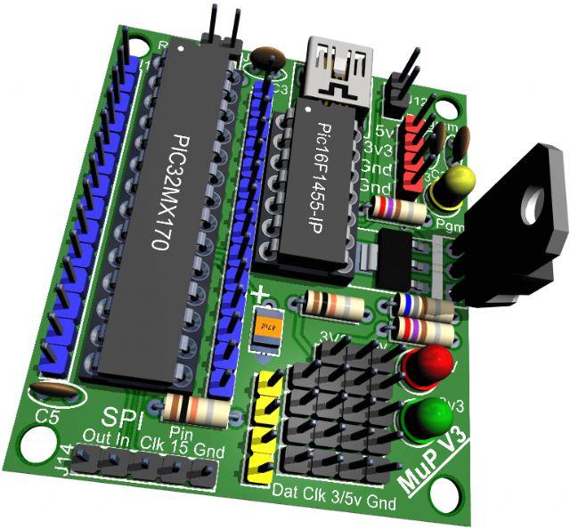

GDay All,
I have just finished testing MuP V3 and I am very happy with it and it is now available if anyone is interested. The most significant difference from Ver 2 is the addition on a PIC16F1455 loaded with MicroBlocks Serial-TTL/Programmer code. This chip (I called MB chip) will do the USB-TTL serial conversion (eliminating the need for a separate board or cable and will also act as a Programmer to program the PICMX170 with a new HEX file, using PIC32PROG (a freeware program). This chip will be available from MicroBlocks directly or through myself as I have an agreement with Microblocks to distribute these directly.
The main differences from MuP Ver 2 (which will still be available) are:
1. MuP Ver.3 may now be built entirely using through-hole components. The only SMD
components are the VCap (which I have added two THP pads to use a standard
Tantalum if you chose to do so) and VReg 1 (which may be substituted by a TO-220
version, in the VReg 2 position). NOTE!! Do NOT install both VRegs as that will
cause instability of the power supply.
2. Removed the option for a USB-TTL cable as the on-board MB chip does that function
for you.
3. Added a 5 pin SPI header interface.
4. Added a Reset header.
5. Added a Pgm header. (see details later in this document)
6. Added a Pgm LED. (see details later in this document)
7. Added support for the MB chip.
8. Added a mini-USB (THP) connector.
The Bare PCB will be available for $3Aus (roughly $2US) ea and I am offering the MB chip at $8Aus (roughly $5.50US).
I will post a purchase link as soon as Don gets time to add it to my site.
Micks `Site'
EDIT ***
There is one minor error on this board in that pin 8 of the PICMX170 is not connected to GND, generally this is not a critical problem as Pin 8 is connected internally to Gnd but the next batch will have this connected..
To fix this a simple 10mm lenth of wire on the underside of the board to pin19 or the PIC chip will correct it.. I will add a note to this effect with any purchase of affected boards.
Mik
Edited by bigmik 2016-07-11

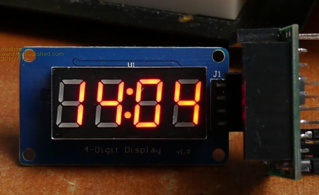

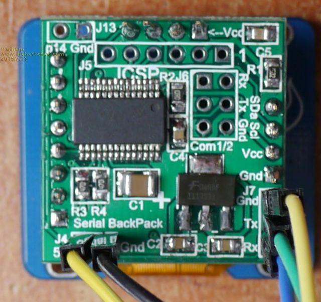

Posts: 12093
Posted: 03:29am 13 Jul 2016
Big shout out for Mick's V2 Serial backpack.
This clever little board interfaces directly with a whole range of displays without any additional wiring and has lots of extra pins free for interfacing with the usual range of sensors etc. This makes it perfect for many small scale measuring and monitoring applications. Note how you can't see the PCB behind the displays it is so small and neat.
ILI9163
ILI9341
TM1637
SSD1306 shown here face down with the PCB mounted to it. NB the version shown is actually the 1.3" variant not the 0.96" version linked which is exactly the same size as the backpack
ST7735 Note, the version linked has the correct pinout. Other versions have the pins differently arranged and won't mount directly.
Nokia5110 Note, the version linked has the correct pinout. Other versions have the pins differently arranged and won't mount directly.

Posted: 07:03am 04 Feb 2017
Mick,
Thanks very much for your MuP work. I am very happy with my 2 MuP3s, but found a problem on the second one which I thought I'd share in case anyone else encountered it.
I2C did not work as it had on the first one. I tracked it down to Dat not being pulled up. Turned out the jumpered pin connected to the top Dat pin was not connected. I retouched the solder on the pins and still no luck.
I soldered a link, but then the 3 lower pins were not pulled up. I soldered a link to the second from the top, and all is fine.
Of course, the top of the board is covered with header pins, so I can't examine it. Perhaps the through-hole plating was deficient, or perhaps I did something while soldering it in the first place.
Hope this may help if someone else is baffled.
