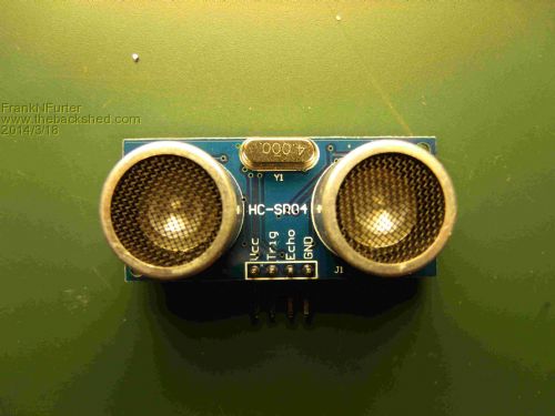

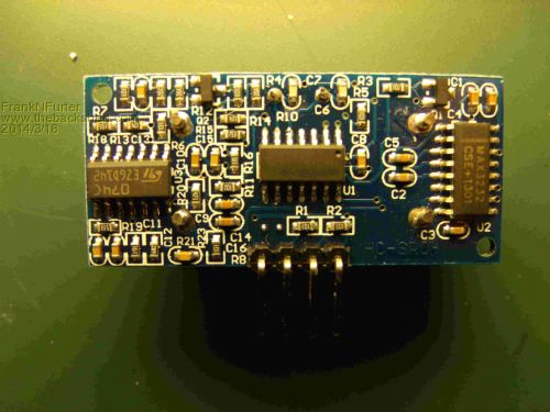

My two sensors are looking similar at first sight to Pauls but they are a little bit different!
They work very well with MicroMite Beta 15:
"to near" => -1 (nearer than 2cm!!!) and "no object" => -1!
I am very pleased!!!
Thanks Geoff!!!

Posted: 08:59am 17 Mar 2014
Hi Frank,
If possible can you please post a picture of the front and the back of your module. I will do the same when Im next at home.
This is purely from an interest point of view. Main thing is Beta 15 seems to have fixed anyone who still had issues with the Distance command halting a program with an error.

Posted: 09:40am 18 Mar 2014
Hi White Wizzard,
here are pictures of my modules:
@Plasma: That's really a very interesting site!
Frank
Posted: 10:10am 18 Mar 2014
Hey Frank,
That is EXACTLY like mine. Thanks for just saving me the time to take photo's here!
As you say, a very slight difference from palcal's when you look closely at component positions.
At least we all have working programs thanks to Geoff's Beta 15.
