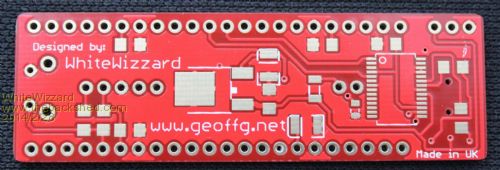

Posted: 11:16am 28 Feb 2014

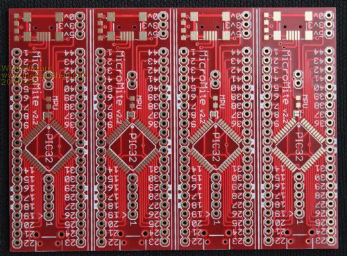

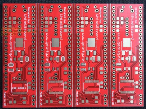

And here they finally are
Chose the red pcb colour option with ENIG finish. They truly look soooo much better in real life than they do in the photos below (apologies about my lack of photography skills. I'm not sure why they keep getting rotated 90deg).
So does anyone have any top tips for cutting panellised PCBs??
I am about to try a tile scorer but am willing to try other methods.
Please do share any experiences (good ones preferably) . . .
Phil
Posted: 11:23am 28 Feb 2014
use a steel ruler and a metal scriber to create a deep score down each side, then just snap off - if necessary starting at one end. DO NOT use a non-metal ruler, and DO NOT use a craft knife. either will likely end up in damaged fingers or worse.
it is a bit late now, but all the places i have dealt with in the past have been able to provide milled groves for breaking apart boards at no extra cost.
rob :-)
Posted: 11:31am 28 Feb 2014
Thanks Rob. This is what I was effectively going to try with my tile cutter so thats good to hear.
iTead don't let you use holes/grooves when panellising (according to their rules) - only a silk screen line to separate the boards (as can see in top photo).
At least I only have three straight lines per panel to create four PCBs.
I read that using a honing stone is a good trick to finish the edges too.
Posted: 12:04pm 28 Feb 2014

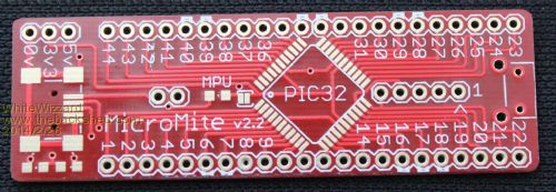

Ok. That wasn't too painful
And I've still got all my fingers and thumbs!
Only another 29 scribes to go . . .

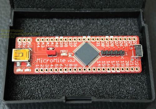

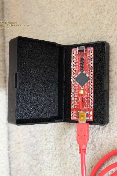

First board successfully assembled and working .

Looks Awesome Wiz..! I'm still waiting for the 28 pinner to show up... Hopefully soon... Maybe do some trading later...
Posted: 08:13am 01 Mar 2014
Sweet!
Very compact and clean design.
I must say your soldering skill is very good.

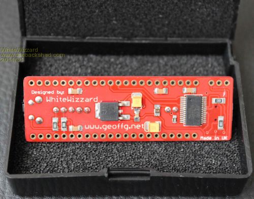

Thanks TZA Even impressed myself - heres the back of the PCB . . .
Geoff: Hope the silkscreen is ok with your www. I based it on comments you made on Zonkers post and also the email you sent me. Please let me know if you want it changed/removed.
