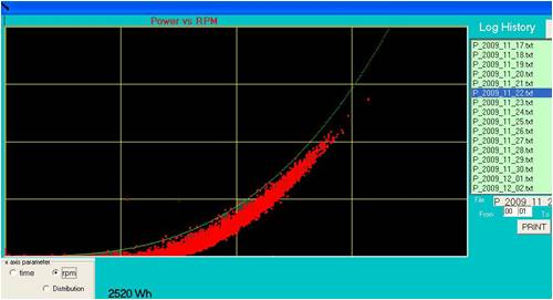

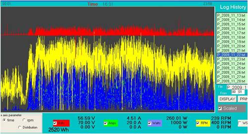

I have been working on the wind distribution component of my Windmill Analyzer and have just picked a windy day from my records last year. My windmill produced about 2.5kWh over the day.
I have included a plot of the actual logged data here.
The red line, is the battery voltage
the yellow line is the windmill rpm
the blue/green line is the battery current.
This next plot is the power output vs windmill rpm. [The loading curve] The rpm goes from 0 to 400 on the x-axis, and the power goes from 0 to 1000W on the y-axis.
The faint green trace is optimum power. The red is the actual windmill power. This is not from a spreadsheet. There is a little data spread due to inaccuracy of measurements.

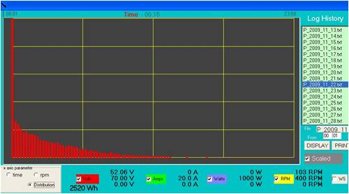

This next plot is a histogram plot of the wind energy distribution. The x-axis goes from 0 to 1000W, and the y-axis is the relative occurence of that power level, in groups, 10W increments up to 1000W.
The first graph shows what we think was the case. It seemed windy, as there was a lot going on with the up and down speed of the windmill and the power levels that were seen.
The second graph shows that the windmill did not appear to miss much wind energy capture, as most of the time, the windmill was operating close to the wind energy curve.
The last curve shows the real wind energy distribution. It is clear that there really is not as much energy at the high windspeeds, as these do not compose much of the total wind energy.

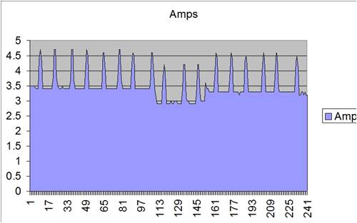

You all have seen Gordons Graphs of his logging examples, and thought i present a different view of data that is still recorded with the same software using the logger we have been working on.
This is putting the data into a excel graph. Very simple to do.
This is only 40 minutes of my house power consumption.
The bottom (X) scale is in 10 second intervals (241 x 10 / 60 = 40 minutes)
You can clearly see when the heater of the water bed cuts in, and it shows we take some things for granted and pay dearly for some creature comforts.
( the water bed is the spikes you see)
I also turned the tv (32" lcd) off in the middle, and the rest is my base load at any general time.
The argument of the cost of running a computer to log the data, i think is null and void from what you learn about where the power bill goes to.
With a amps/watts reading you tend to notice that consumption is higher at times than expected and you go looking for the cause.
You tend to turn off things as its a guilt meter otherwise.
For instance its costing me 0.4amp an hour to have the display on to be on the net here at present.
So to run the pc and no display is 96 watts an hour cheaper.(not always practical)
Pete.

I assume you used the .CSV button to select the data for excel to plot? This saves having to try and find the data to plot from potentially 10000 records in excel.
Those base load power readings are hard to get below 100W. I still have unexplained power consumption in my home.
