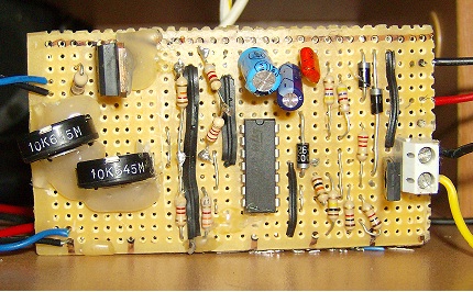

can you post a photo of your board ?
Also check the value and location of the 10k resistor and jumpers.

this is the photo

I don't see one of the jumpers for paralleling the pots, are they both there ?
I'll look closer later.

it is there under the silicon right side of the low volt trimmer

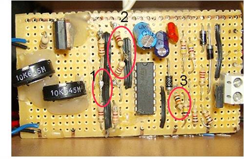

I have a few questions about the board as its a bit hard to see clearly.
1...looks incorrect to me(solder bridge??)
2...What is the combined resistance of R1 here.
3...What value is this resistor as it looks like 1K and should be 10K
What voltages do you have on pins 5,6,7 as looks to be something wrong with op2 voltage, as when op1 (pin1) goes low the relay switches off.
This would indicate op2 (pin7) was high, at the time op1 goes low.
Op2 should be low (1.2 -1.5v) and go high when the voltage is around 12v or adjusted to suit.
You will need to check op2 voltage and get that to be high at 12 volts and go low at about 0.2 volts above 12v.
This not happening so no hysterisis.
Pete

I also noticed you did not use a socket for the ic, so I must ask what type of iron and heat settings you used when soldering on the chip itself especially if you have tried more than one.
Bob

1 i just cut the resistor and test the resistanse and then resolder it again it seems that is bridged but it is not i left some of the wire and it is above the other resistor show it seems like a bridge.
2.the combined resistance on my multimeter is 10,2k oms
an 8k and a 2,2k
3 10k the last one i had it has a thiker red line, 3 times check on my multimeter .

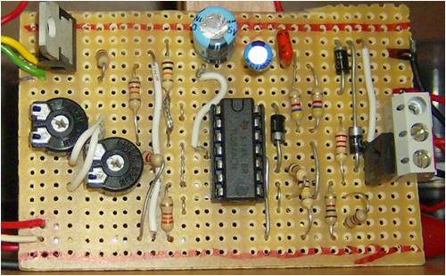

this is the third board and this is the readouts
12v 13.5v 15v
0.61 1 14 6.46 0.61 1 14 6.46 0.61 1 14 6.45
3.53 2 13 3.92 3.71 2 13 3.94 3.89 2 13 3.34
2.83 3 12 5.90 3.21 3 12 5.90 3.47 2 12 5.90
7.89 4 11 0.01 7.89 4 11 0.01 7.89 4 11 0.01
2.85 5 10 0.01 3.21 5 10 0.01 3.47 5 10 0.01
2.86 6 9 7.10 3.21 6 9 7.32 3.47 6 9 7.32
7.10 7 8 590 7.28 7 8 5.90 7.32 7 8 5.90
