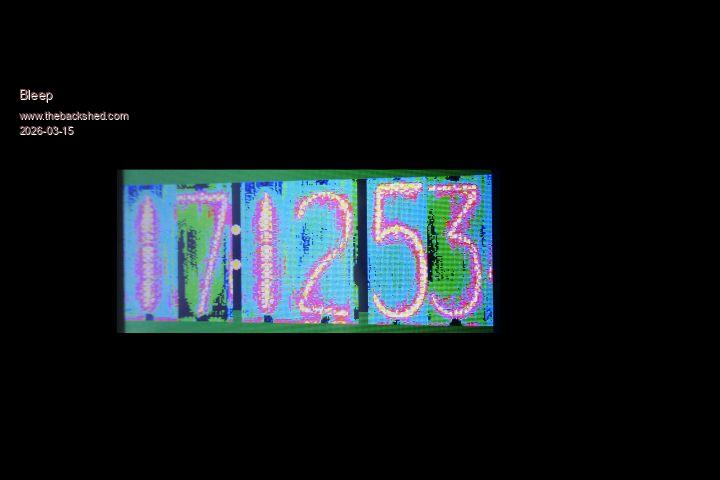

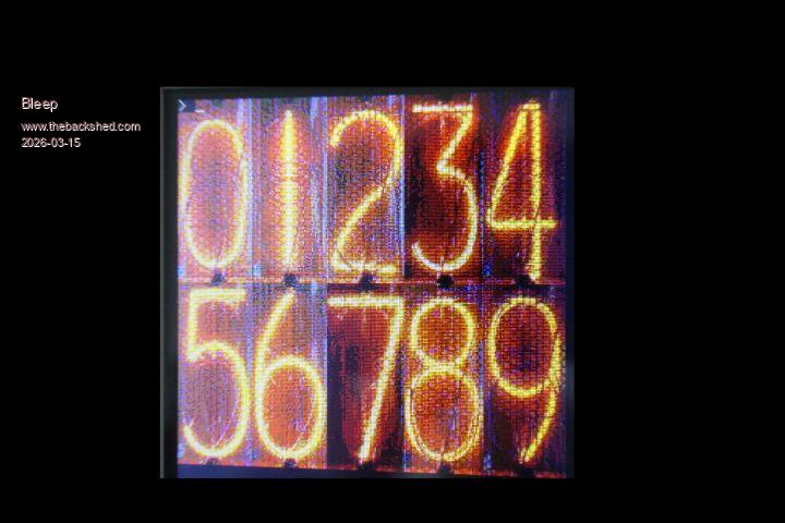

Hi Peter,
I am using a ST7796S on a USB RP2350A Edition V6.02.01RC6.
I am loading a jpg to the screen.
I then Blit Read each digit, I then Blit Write the digits to create a nixie display, but what I get back is
I was told, maybe wrongly, that Blit Read preserves the colur depth? the manual says RGB888.
I have also tried the dithered load, for 255 colours, I get different, but similar results.
I think I have bridged D1 and J1, it's now difficult to check :-( would I get colour distortion like this if I hadn't?
Or is this something that should work?
Regards Kevin.

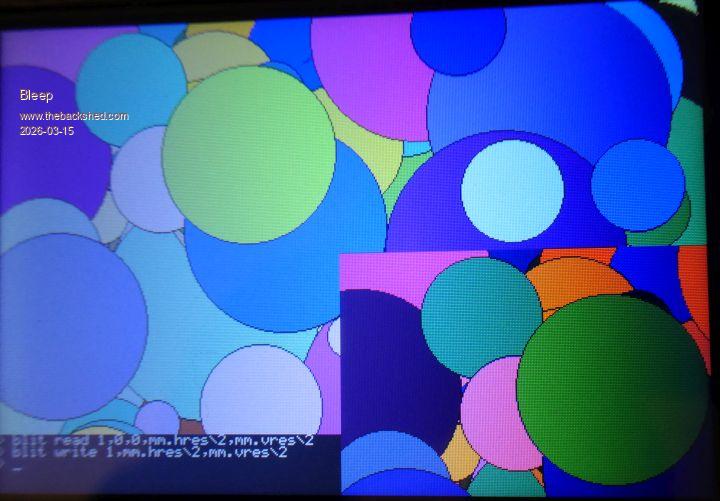

Kevin
Just tested a st7796S and it works fine.
Try this.
GUI TEST LCD PANEL
ctrl-C
blit read 1,0,0,mm.hres\2,mm.vres\2
blit write 1,mm.hres\2,mm.vres\2
If you post the jpg and your code I can test with that as well
Edited 2026-03-15 05:56 by matherp

Hi Peter,
doing the test you suggest I get the following, so the colours have changed.
One subtilty with my set up, is I am using the LCD on it's own SPI, I did this to get the maximum speed out of the disply.
OPTION LCD SPI GP26,GP27,GP28
OPTION SYSTEM I2C GP20,GP21
OPTION FLASH SIZE 4194304
OPTION COLOURCODE ON
OPTION KEYBOARD ES, 0, 0, 170, 100
OPTION CPUSPEED (KHz) 378000
OPTION LCDPANEL CONSOLE 7,,, 50
OPTION DISPLAY 40, 80
OPTION LCDPANEL ST7796S, LANDSCAPE,GP12,GP13,GP14,GP15
OPTION LCD BACKLIGHT 50
OPTION TOUCH GP17,GP7
GUI CALIBRATE 0, 3944, 3891, -1289, -857
OPTION SDCARD GP22
OPTION KEYBOARD REPEAT 170,100
OPTION AUDIO GP10,GP11', ON PWM CHANNEL 5
OPTION RTC AUTO ENABLE
OPTION MODBUFF ENABLE  200
OPTION DEFAULT FONT 7, 1
Could this be causing a problem?
Files you requested.
nixie (2).zip This is very much a cobbled together piece of code, just for testing.
As a complete asside, I have been finding, that the OPTION LCD CONSOLE keeps loosing the 'Noscroll" paramater, (as above), I always put it in for this screen, but after some time, it vanishes?
Regards Kevin.
