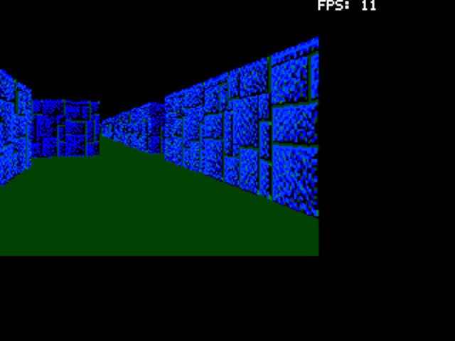

Okay, this is a first attempt at implementation with the new BLIT RESIZE feature. It only works with the latest firmware update (PicoMite V6.02.01 release candidate) and, for now, only on Pico.
ccast1.zip
This is a quick integration of the new function/command. Just to see the difference.
As a reminder, 11 FPS * 120 calls = 1,320 BLITs per second(not including the whole Raycast calculations..)
The adjustment for MMB4W/CMM2 via Image Resize will come later.
Enjoy testing it out!

Posted: 05:06pm 05 Mar 2026
WOW WOW WOW Martin,
I am more than impressed. Thanks also to Peter ;-)
It runs quite well on my HDMI USB Pico2. Not necessarily for a shooter, but for a 3D maze or role-playing game, it works really well.

Hi Martin,
I have tried out your latest ccast1 program from above on 480x320 LCD ST7796S, 2350 running at 420MHz.
All I had to do was remove the Mode 2, everything then just worked, full screen.
At this resolution I'm getting around 10 to 11 fps. If I limit the screen size to 320x240 (using Poke Display Hres 320 & Poke Display Vres 240) I'm seeing an update rate of about 18 to 20fps. Not Bad! :-) but may not leave much spare for other processing :-(
If I limit the CPU to 252MHz I get around 6 to 7fps and 10 to 12fps respectivly.
Regards Kevin.

Posted: 05:36pm 05 Mar 2026
Kevin,
if you use 480x320 the Programm uses 360x240, so it has to do 180 Blits per Frame. Of course this takes longer, but the graphics are also nicer.You compensate for that with the higher clock speed (430 vs 252). For some reason, I can't get my Pico2 above 252 at the moment (or maybe I'm just too stupid). And yes, you're right, in the current state, there's no CPU time left here for other calculations such as game logic or similar.
On the other hand, when I think back to my first attempts at ray casting a few years ago (with Pythagoras), this is with DDL already a quantum leap. . I think we have to find a middle ground here, using texture mapping or box commands, depending on what you want to programme, (or we can think of other tricks to save CPU time).
Martin
