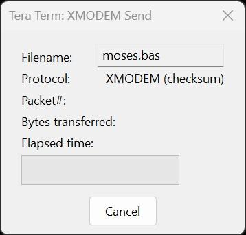

XMODEM RECEIVE
works fine but
XMODEM RECEIVE "structest.bas"
hangs up. The transfer never starts but Ctrl-C exits OK. I'm using EXP5 on a Pico2350DIL V1.2.

You don't say what you are using to transmit. Works perfectly for me EXP5 Pico2350DIL V1.2 with W11/Teraterm. Paste line delay set at 20mSec

  matherp said  You don't say what you are using to transmit. Works perfectly for me EXP5 Pico2350DIL V1.2 with W11/Teraterm. Paste line delay set at 20mSec
I'm using Tera Term 5.40 on Windows 11. The box below never changes
Here are my options:

Re the xmodem issue, what exact version of the firmware are you using USB? normal? What options?

  matherp said  Re the xmodem issue, what exact version of the firmware are you using USB? normal? What options?
I'm accessing the Pico2350DIL through the USB port. When I do an OPTION RESET, XMODEM "filename" works. When I use the options below, it doesn't. I've tracked it down to the SERIAL CONSOLE option. If I remove that option, XMODEM transfer works with a filename.
