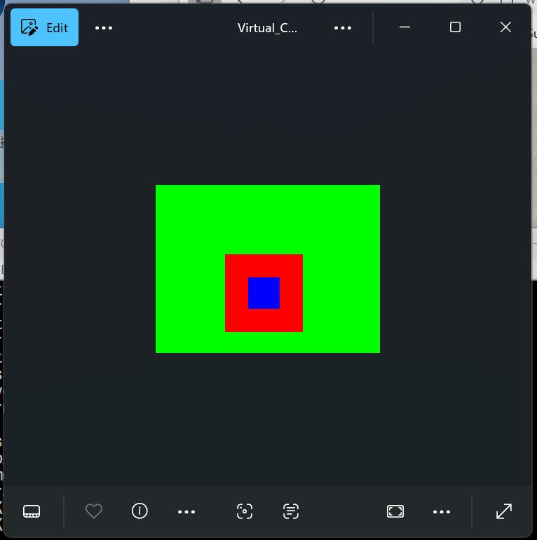

Posts: 3416
Posted: 06:37am 06 Jan 2026
As this firmware is now frozen this is just for information.
OPTION LCDPANEL VIRTUAL_C appears to have a bug on the basic RP2040.
Note its OPTION LIST entry. GP16 & 18 can still be used as normal.
CLS RGB(any colour) results in a black background.
Saving a large box image uses too much memory.
> option list
PicoMite MMBasic RP2040 V6.01.00
OPTION FLASH SIZE 16777216
OPTION COLOURCODE ON
OPTION CPUSPEED (KHz) 378000
OPTION DISPLAY 52, 150
OPTION LCDPANEL VIRTUAL_C,GP16,GP18
OPTION AUDIO GP18,GP19', ON PWM CHANNEL 1
> cls rgb(green) '<---results in a black background when saved
> box 0,0,320,240,1,rgb(green),rgb(green)
> box 99,99,111,111,33,rgb(red),rgb(blue)
> save image "Virtual_C test.bmp"
Error : Not enough Heap memory

Posts: 12057
Posted: 08:38am 06 Jan 2026
I've just repeated with V6.02.00RC0 and it all seems to work fine, including cls rgb(green) and save giving a green image. Please could you retest and confirm on that version - thanks
Edited 2026-01-06 18:41 by matherp
