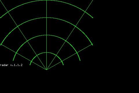

Posted: 07:58pm 09 Dec 2025
Ok. I had some 2mm female header. Soldered it on to a 2.54m female header after bending pins on both, and plugged that into the white connector on the HLK-LD2450. I plugged it into a USB-serial module, plugged it into my PC, set the baud rate at 256000, and could see characters. Mostly not printable ASCII.
I plugged it in to a Pico1 with latest firmware and ILI9488 LCD, downloaded the .bas file from Radar_v.1.1.2-blit.zip, set the serial port (double checked pin # and Rx/Tx, but could be wrong), and got this:
So that's a good start, but I have no dot, so 2 questions:
How should I determine whether I'm getting serial input, and
Where do I make changes for the ILI9488 480x320 LCD?
Posts: 6626
Posted: 08:32pm 09 Dec 2025
Try this
 ARC MM.HRES/2,MM.VRES,60,,285,75,RGB(GREEN)
 ARC MM.HRES/2,MM.VRES,120,,285,75,RGB(GREEN)
 ARC MM.HRES/2,MM.VRES,180,,298,62,RGB(GREEN)
 ARC MM.HRES/2,MM.VRES,240,,318,42,RGB(GREEN)
 LINE 0,0,MM.HRES/2,MM.VRES,,RGB(GREEN)
 LINE MM.HRES/2,0,MM.HRES/2,MM.VRES,,RGB(GREEN)
 LINE MM.HRES,0,MM.HRES/2,MM.VRES,,RGB(GREEN)
 LINE 0,150,MM.HRES/2,MM.VRES,,RGB(GREEN)
 LINE MM.HRES,150,MM.HRES/2,MM.VRES,,RGB(GREEN)
The target should appear after it sees movement. Wave a hand in front should be enough.

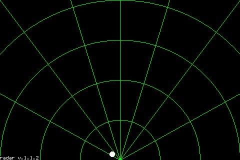

Posted: 11:41pm 09 Dec 2025
have just made a version that adapts the radar-grid automatically to the lcd (or whatever is used) size and also extends the straight lines up to the lcd borders. Also arc is replaced by circle because its easier to code and probably faster. The BLIT technique is kept, as it really saves cpu cycles and/or ram compared with redrawing the grid or using layers.
Introduced a new sub "get_intercept" which gets the nearest intercept point with one of the lcd borders in order to draw the lines up to the border. It's a simple intercept calculation of 2 lines, border and gridline using good ole substituion method. See my comments in the code ....
Radar_v.1.1.2-blit-2.zip

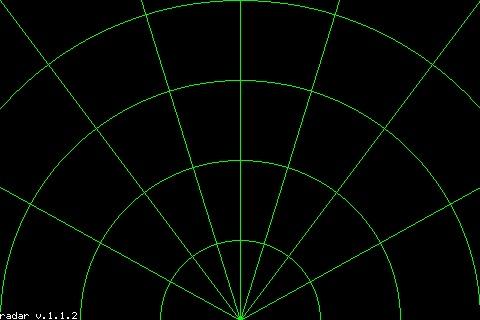

Posted: 01:57am 10 Dec 2025
Beautiful screen now with Radar_v.1.1.2-blit-2.bas.
But still no dot. I swapped Rx & Tx just in case, but no difference. Tomorrow I'll hook up those Rx & Tx pins from the PicoMite through a USB-serial module to confirm whether I've got them right.
BTW, "H", "P", and "Z" did not result in any output.
Are the arcs at any predictable distance from the module?
Edited 2025-12-10 12:01 by lizby
Posts: 6626
Posted: 03:17am 10 Dec 2025
Try this short test program
 OPTION EXPLICIT
 OPTION DEFAULT INTEGER
 OPTION BASE 0
 DIM n, rec$
 SETPIN GP5, GP4, COM2
 OPEN "com2: 256000" AS #3
 DO
   rec$ = INPUT$(255,#3)
   IF LEN(rec$)>0 THEN
     FOR n = 1 TO LEN(rec$)
       PRINT HEX$(ASC(MID$(rec$,n,1)),2);
       IF (n MOD 40) = 0 THEN PRINT
     NEXT n
     PRINT
   ENDIF
 LOOP
Change the setpin and open com lines to match your setup
The output should look like this:
AAFF
03006D810E81000068010000
000000000000000000000000000055CC
AAFF
030084810881000068010000
AA
FF03009781018100
0068010000000000000000000000000000000055CC
AA
FF03009E81F58000
Edited 2025-12-10 13:18 by TassyJim

Posted: 07:59am 10 Dec 2025
lizby,
- you still do not get any data from the sensor, if the program does not react on keys pressed, there is no sync with the sensor. Again, please check the wiring and the com-port settings in the program or your sensor may be dead.
Are you using 5 Volts for Vcc as stated in the datasheet? I Think 3.3 Volts may be too low if used. The little beast draws some current for the transmitter .... I've connected my sensors Vcc to the Vbus pin on the pico. A good GND connection also always helps. If you have a scope, check the sensor TX line for bits coming along. From the short ones you can calculate the baudrate. I also use one of this 10$ USB logic analyzers from Aliexpress. They work up to 20 Mhz reliably and let you have the data from the serial line also decoded into hex or ascii. Have modified their python script a bit to also show control chars, Great for debugging.
edit (forget the rubbish I wrote before):
- The arcs can be made to show a predictible distance. the factors are in the program at the lines
 const v_fact = mm.vres/8000
 const h_fact = mm.hres/6200
set them to whatever pixel/mm you want to show on the display, but make sure both corrdinates have the same factor in this case.
Gerald
Edited 2025-12-10 18:26 by ville56
73 de OE1HGA, Gerald

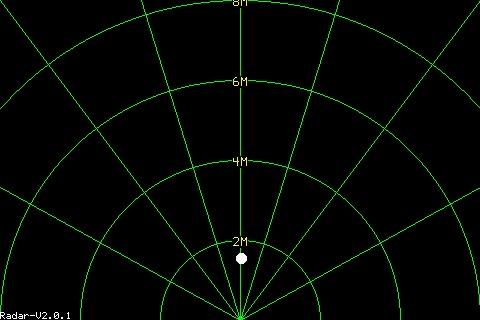

Posted: 07:55pm 11 Dec 2025
Working now, thanks, all. The pin labelled "0V" on my PCB was not actually connected to 0V.
This will be fun to play with. I'd like to map it to the area around my shed. How far out does it range, and any suggestions as to how to label the arc distances from the module--perhaps at the intersection of each arc with the line which goes to the upper right corner?
(Sorry to be asking these questions, when I could investigate. AI has me spoiled for asking questions. Nice also to have some non-artificial intelligence to query.)

ville56
Joined: 08/06/2022
Location: Austria
Posts: 646
Posted: 01:48pm 12 Dec 2025
Lizby,
no need to interrogate AI, this is natural NI (No Intelligence) answering
- as I wrote, a good GND connection is always your friend (had that already myself several times)
- the max range of the sensor is 8000 mm as of the datasheet. It certainly also depends on the size of the target how far the actual range will be.
- the attached V2.0.1 has now distance labels. You can modify the parameters as you like. They are at line 101 onwards, please read the comments. But labeling in feet and inches may be a bit of a challenge ... at least for me as a metric guy.
Radar-V2.0.1.zip
