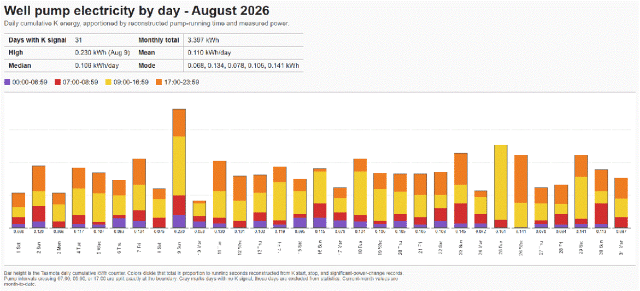

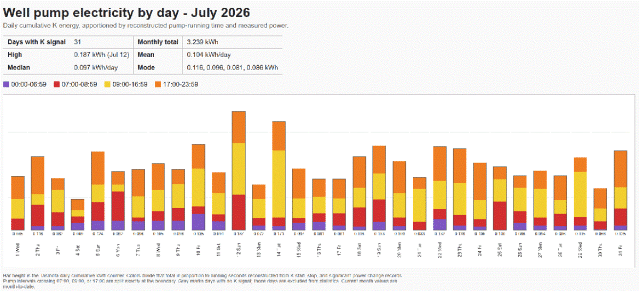

Prompt to Chat's codex (connected via serial to a Seagate Dockstar running OpenWrt):
  Quote  I'd like to have a monthly chart of well pump draw by day. Starting in June, produce a chart, "/www/charts/pump2606.html" which has a vertical line per day, with 12am-6:59am in purple, 7-8:59am in red, 9-4:59 in yellow, and 5-11:59pm in orange. Label each date with day number and day of week "Mon", "Tue", etc. Counting only days for which there is a signal, provide monthly high, mean, median, and mode. Produce June, July, August, and September-to-date charts, and then have it run each day with the last cron run of the day, updating the month to date. All onDock80_70. When one of the time transitions occurs during a pump run apportion the colors according to the time ratio.
Nothing further for me to do but look at the output.
This shows me again how little electricity it takes to provide the house with water from the well--in two months a maximum of about .25kWh in a day and an average of about .1kWh. That's on average about $.02 Canadian a day. The hard part is providing what is needed for the inrush current--upwards of 7kw for a fraction of a second.

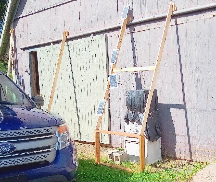

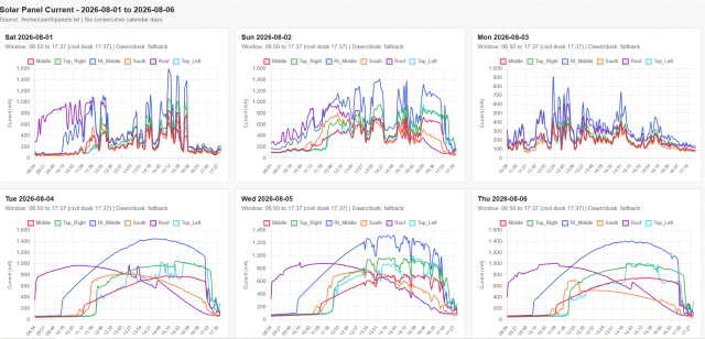

I've been tracking 6 mini solar panels with 6 INA226 modules and an ESP32 C3Supermini to see what clouds and shading is like on the face of my barn.
There's an offscreen panel to the right on the ESE-facing barn roof.
I had Chat produce a daily chart served on a Seagate Dockstar running OpenWrt. Today I asked Chat codex to gang six of these charts per HTML page. It had forgotten how to talk to the Dockstar, so phaffed about for a while doing that, but then produced 22 pages since May 15. Here's one with a couple of the least cloudy days.
After giving the prompt (which I had browser Chat prepare), I had only one interaction: telling it that I had installed base64, which it had noted that it had tried to use for sending a program but it was unavailable (it completed without using base64).
This makes it easy to see the massive effect that clouds have on these little panels.
