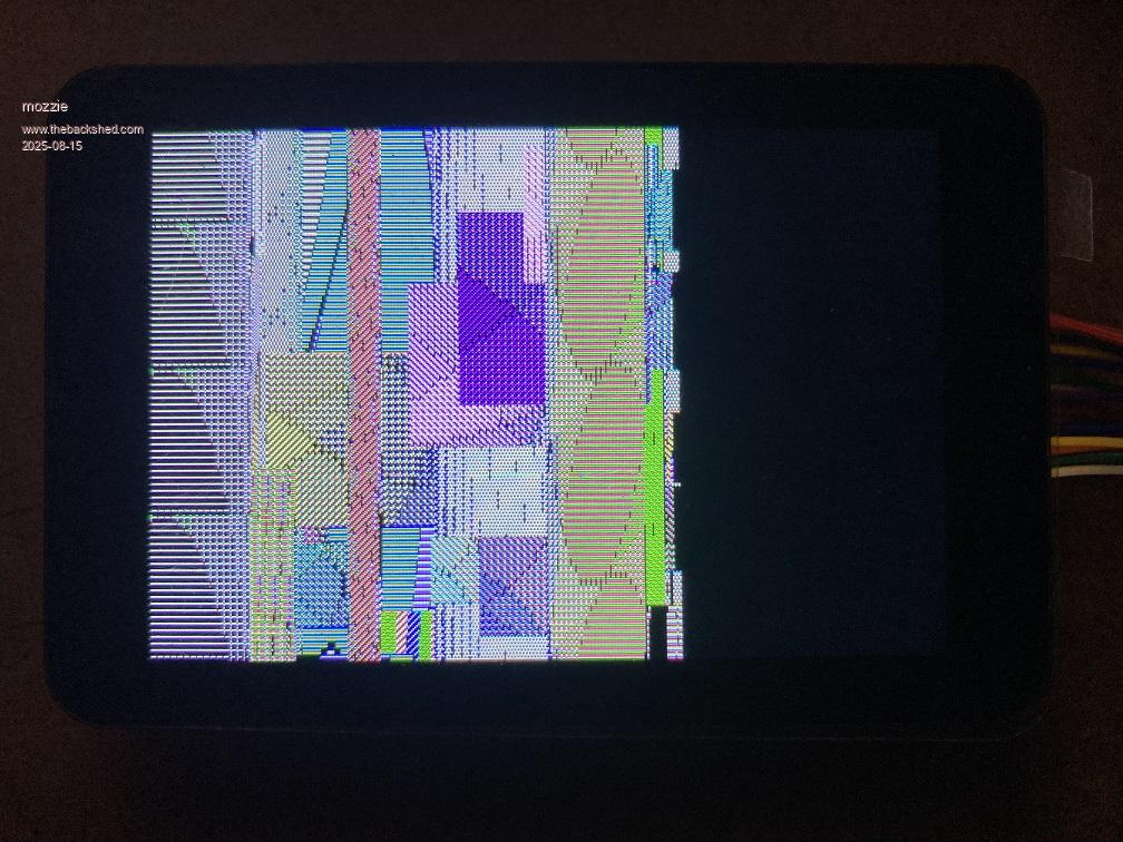

Further to previous post, this is a photo of the corrupt display on ST7796S:

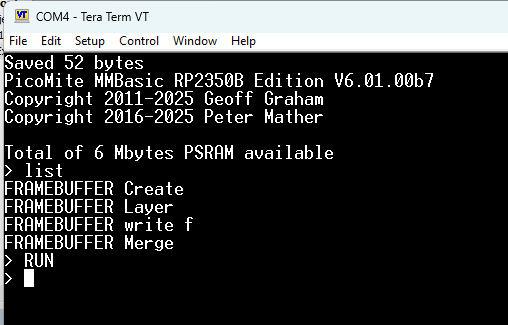

  Quote  The FRAMEBUFFER MERGE command either locks up the PicoMite, requiring a reboot and occasional loss of all options and program, or "Incorrect Address - Resetting" (I think) possibly depending on whether the buffered driver is used or not.
Just run your Lissajous program all night on an ILI9341 with the buffered driver and no issues. Also tested with the non-buffered driver and again no issues
FRAMEBUFFER MERGE 0,b '<======== copy both layers to the screen
PicoMite MMBasic RP2350B Edition V6.01.00b7
OPTION LCD SPI GP2,GP3,GP4
OPTION FLASH SIZE 16777216
OPTION COLOURCODE ON
OPTION PICO OFF
OPTION CPUSPEED (KHz) 360000
OPTION LCDPANEL ILI9341BUFF, LANDSCAPE,GP26,GP27,GP28,GP5
OPTION PSRAM PIN GP47
  Quote  Also noticed the Waveshare ST7796S LCD with the buffered driver on LCD SPI:
CPUSPEED OUTCOME
48-172MHz Works
176-180MHz Corrupt/No display
184-300MHz Works
304-332MHz Corrupt Display - Photo to follow
332-344MHz Works most of the time
344-360MHz Corrupt/No display
The LCD SPI / Circles per second wrap @ 180MHz so the above makes sense, possibly just reaching the maximum data rate this display can handle.
Not for me - works perfectly at all speeds (4" ST7796S display)

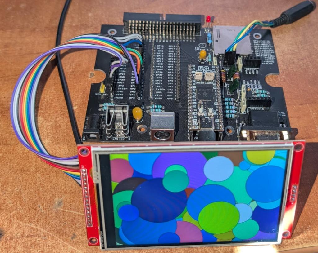

One thought - please explain how the displays are wired. In my test environment the LCD SPI pins connect ONLY to the LCD. Touch and SDcard are wired to the SYSTEM SPI. This is essential you mustn't have anything other than the display connected to the LCD SPI pins. There is nothing tidy about my wiring and yet it seems completely stable.
Every display, touch, SDcard uses different SPI speeds. I am pushing the ST7796SBUFF to the extreme (90MHz) - see the config table below. The default LCD_SPI_SPEED is 25MHz.
We need to identify what is different about the configuration of those experiencing issues compared to my setup.

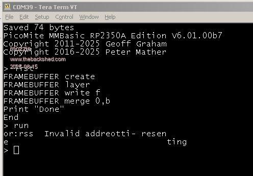

I've tested the Framebuffer Merge, as it looked like there might be a problem on the 6.01.00b and I do believe there is a problem.
I am using :-
PicoMite MMBasic USB RP2350A Edition V6.01.00b7
OPTION SERIAL CONSOLE COM2,GP8,GP9,BOTH
OPTION LCD SPI GP26,GP27,GP28
OPTION SYSTEM I2C GP20,GP21
OPTION FLASH SIZE 4194304
OPTION KEYBOARD US
OPTION LCDPANEL CONSOLE 7,,, 50,NOSCROLL
OPTION DISPLAY 40, 80
OPTION LCDPANEL ST7796S, LANDSCAPE,GP12,GP13,GP14,GP15
OPTION LCD BACKLIGHT 50
OPTION TOUCH GP17,GP7
OPTION SDCARD GP22
OPTION AUDIO GP10,GP11', ON PWM CHANNEL 5
OPTION RTC AUTO ENABLE
OPTION DEFAULT FONT 7, 1
The LCD SPI is only connected to the LCD, nothing else.
I have tried various CPU speed setting, again, no difference.

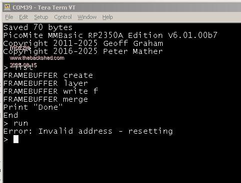

The simpelest program to demonstrate is:-
Framebuffer Create
Framebuffer Layer
Framebuffre write f
Framebuffer Merge
'Or Framebuffer Merge 0
'Or Framebuffer Merge 0,r,100
This will completely lock up the Pico, no output to LCD screen or USB console, though the heartbeat is still flashng, it requires a power off and on. I have done a full Option Reset and manually put everything back in and the problem was still present.
Regards, Kevin.

Hi Peter,
Did a Option Reset, so completly default, then only put back the LCD SPI and the LCD definition itself, then using the simpelest test below, the screen goes white, then clears, but the Pico looks like it has rebooted, ie I'm seeing the re-initialisation of the USB ports message, as below.
> run
> US USB Keyboard Connected on channel 1
> USB Mouse Connected on channel 2
If I attempt a background merge with:-
Framebuffer Merge 0,b
I do get a invalid address error.
> RUN
Error: Invalid address - resetting
Framebuffer Create
Framebuffer Layer
Framebuffre write f
Framebuffer Merge
Hope this helps.

Hi Peter,
Sorry for the delay I've just been out MTB'ing before it gets too hot. ;-)
I dont have a non USB 2350, so I've installed the non USB firmware onto my USB.
I can confirm that the Merge command does work on :-
PicoMite MMBasic RP2350A Edition V6.01.00b7
OPTION CPUSPEED (KHz) 150000
As does the Lissajous program now as well. :-)
Regards, Kevin.
