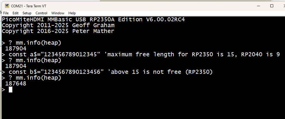

  Quote  I know it's too late for this release, but maybe an idea for the next one? Is it possible to automatically set the lengths of string constants? This means that MMBasic or the preprocessor limits the memory usage to the value required by the string constant, a kind of automatic "LENGTH" command in the background.
Yes - will be in the release

V6.00.02RC5 is available on
Implements automatic length adjustment for string constants. Where strings are less that 15 characters (RP2350) or 9 character(RP2040) no heap will be used. NB: prior to this release RP2350 only allowed 7 characters in a string without using heap.

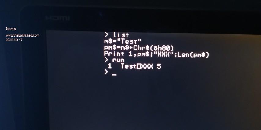

Posted: 03:55pm 16 Mar 2025
Okay, this behavior seems to be new!
In the console, non-displayable characters are suppressed as usual in the output, this was also the case in the HDMI/VGA output ...
> list
m$="Test"
pm$=m$+Chr$(&h80)
Print 1,pm$;"XXX";Len(pm$)
> run
1      TestXXX 5
Now a square appears there (see picture).
Is this new behavior desired?
Matthias
Posts: 12059
Posted: 04:06pm 16 Mar 2025
  Quote  Okay, this behavior seems to be new!
No been like this forever. Some fonts have characters above chr$(127)
Manual page 65

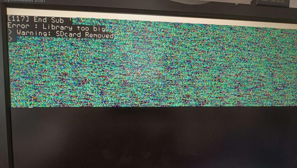

Posts: 299
Posted: 09:27am 18 Mar 2025
@Peter
HDMI/USB/2350
I can`t get in what`s so wrong with my libraries but all previous betas, and now 6.02RC5 still wil not LIBRARY SAVE. Only works in a way, if I first CMM2 LOAD and later cmd LIBRARY SAVE
help.zip
Tray if it works for you LOAD and LIBRARY SAVE.
And not with this file only.
Just created another 30 kb lib, and was not able to save (without prior CMM2 LOAD).
Betas were reseting with timeout error and RC5 just resets silently (or at least clears to defaults, can`t say really)
Manual seems allow LIBRARY SAVE anytime you wish without use of CMM2 LOAD.
While it is clever thing to chrunch before library save, I feel official user manual must have additional notes or it might need some firmware fix.
My MMBasic 'sand box'
Posts: 9238
Posted: 09:40am 18 Mar 2025
As far as I can see LIBRARY SAVE simply moves the contents of Flash Slot 0 to Flash Slot 3 just stripping out some spaces and comments as it does so.
If you have a library then you must reload it from scratch after updating MMBasic as tokens may have changed and your existing library, even if it hasn't been deleted, may be corrupt.
Posts: 12059
Posted: 10:00am 18 Mar 2025
You need to isolate what in the program is causing the problem and then I can investigate. CMM2 LOAD does a crunch on the program removing blank lines/comments etc. You can also try AUTOSAVE C to load the original program and see if that saves to the library OK.
If that works start adding back comments etc. to see what breaks it.
I didn't write the library routines. So once we identify what causes the problem I can ask Gerry to have a look.

Posts: 6197
Posted: 11:01am 18 Mar 2025
@electricat,
With your "help.zip" the GEEK also crashes when doing a library save.
Also after I replaced all DIM with LOCAL it still crashes (reboot / USB reconnect).
Something in this program upsets the LIBRARY SAVE.

electricat
Joined: 30/11/2020
Location: Lithuania
Posts: 299
Posted: 12:17pm 18 Mar 2025
@Peter, Mick, Volhout, bfwolf and all
Like Volhout noted, small SUB saving does not causes problem for me too.
I felt it is connected to library size, becouse I was removing 'suspicious' SUBs only later to find other line causes problem. (I did all kind of things like looking at file in HEX editor, removing subs, coments, lines etc... also looking through in notepad++  with all 'invisible' chars switched on ... )
What I did, I CMM2 LOADed library and just copy/pasted to make library 'big' meands, 31 Kb in size. (If I do not RUN anything, technically it does not matter if subs inside of it are duplicated or not.)
cmm2 crunched.zip
See what I got!
If FLASH SLOT 3 is 100 kb, no way 31 Kb lib would cause such result
electricat
Joined: 30/11/2020
Location: Lithuania
Posts: 299
Posted: 12:20pm 18 Mar 2025
Something wrong with flash adress I believe
