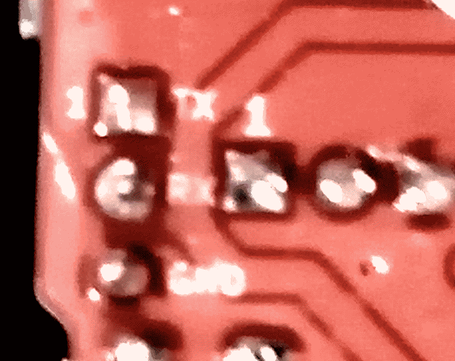

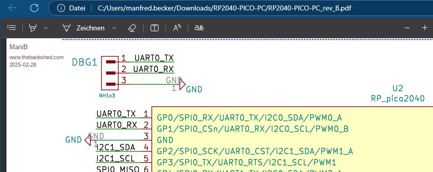

  matherp said  Use OPTION RESET OLIMEXUSB and connect to the serial port header next to the USB
Found it, thank you Peter.
Unfortunately, the Olimexboard did not include a description or circuit diagram, hence the question
'no comment
Posted: 08:56am 28 Feb 2025
  Martin H. said  Unfortunately, the Olimexboard did not include a description or circuit diagram
Which board is it?
Usually they provide both :)

It is also shown in the schematic:

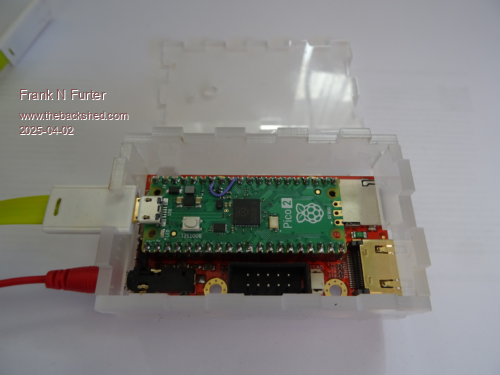

Hi Christian,
1. What kind of documentation are you missing? Actually, everything is right here:
https://github.com/OLIMEX/RP2040-PICO-PC
3. I have a very small wireless keyboard here - but I first have to test whether it works with the device...
4. Where do you come from? I lasered this housing at FabLab here. I may still be able to get hold of the data:
Frank

  Xian said  I am living a bit south to Münster - from your nickname i assume you're close to the river Main.
Not really! I live near Nuremberg.
  Xian said  If you could send the data for the case, that would be very kind.
It will take a little while. I have to contact someone first (I should have taken the data with me when I helped design the housing...). I would also like to have a few of the housings laser cut again.
