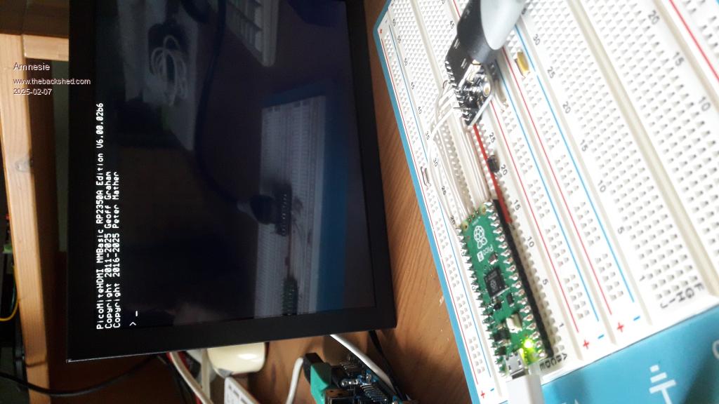

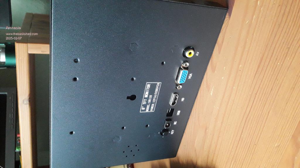

Today my new Eyoyo (China) Monitor arrived. And as I've predicted to you:
IT WORKS without any problems in every resolution (HDMI) VGA does work too, love that little 4:3 thingy
Just out of curiosity I knocked on the breadboard-cables, bend them around. ROCK SOLID. There must be some kind of buffer (?) circuit? Otherwise I can not explain why there is no degradation at all.
Thanks to the metal frame I may build a project around it. For around 60€ insane. Built-in speaker, and adjustment menu (something the raspberry pi monitor doesn't have!)
I can't understand why the raspberry pi monitor is so freaking bad.   I'm glad I returned it.
EDIT: Forget to mention it even is an IPS display, looks bright and sharp!
Greetings
Daniel

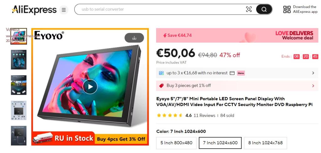

Posts: 6197
Posted: 02:20pm 07 Feb 2025
I have the same (build in my main testing rig). Or maybe not, mine is 16:9, but I adjusted in the menu to 4:3 for VGA. But it is IPS, great viewing angle, and bright.

As mentioned: 8" 4:3 format IPS display and in germany it costs around 60€ it was even shipped from germany (china seems to have a stock here).

Posts: 6197
Posted: 02:35pm 07 Feb 2025
Hi Daniel,
Let's see if yours has the same flaw mine has. Can you get into the menu, when there is no video signal connected ? The rear panel menu button is a "joy stick" button. You use it to navigate.
Here is the difference, mine is the 7" 1024x600.
Edited 2025-02-08 00:40 by Volhout
