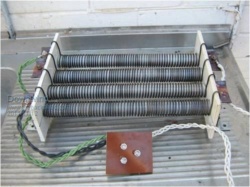

I also disagree with the use of light globes for a dump system, as Glenn has said, its fine for battery dumping but otherwise its a failure waiting to happen.
It is so simple to use wire wound around old fluro tubes to make a suitable dump resistor bank.
The way i done this is to cut the end off a fluro tube and insert a 1/4" rod fill it with cement and then remove the rod when the cement is set but still green leaving a hole through the core.
Once cured cut the tube to length and use 1/4" allthread to mount the sections between a cut up floor tile for insulated end plates.
Or you can just use the full fluro tube as many have done.

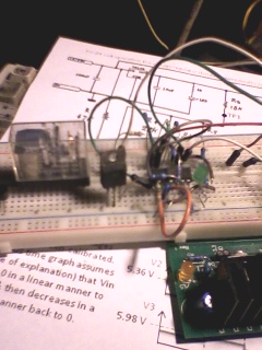

well i am going to knock up the cct that len described on page four i will use a breadboard ..i have the chip and caps but have to dig up some of the resistors and will be hopefully have it running sunday arvo sometime...
with a 260 ohm coil i calculate that this comes to 54 ohms ...would this be correct...????

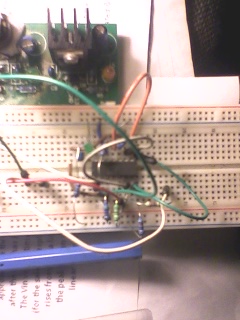

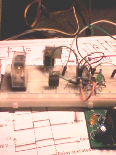

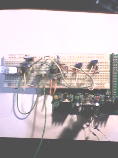

i also think you have a floor in the fact that "R 1"is already connected to the 12 volt line or is it a missprint on your calibration that "in sterp three if you connect a 47 k in paralell it will be connected to the twelve volt line allready...
there is most of it done i just have to test out a 7808 reg and add the trimpots and find a 56k and a 56 ohm have a relay not shown thought i`d give you a pic
i am using a irf 640 thats what i had its n channell......have a question though does the sorce go to the relay or the drain ...i dont do much fet work i am not shure.....
there its finished i think will go over it as bread boarding can get hairy........
Edited by sparkey 2011-11-14

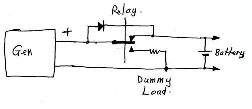

Thanks for your comments, Pete.
Here is the the idea I referred to above. I think it meets Glenn's requirements since the diode is shorted when the relay is released but prevents draining the battery when it is operated. However, the diode will pass any voltage spikes to the battery. I have not included the protection components.
Len

  sparkey said   i also think you have a floor in the fact that "R 1"is already connected to the 12 volt line or is it a missprint on your calibration that "in sterp three if you connect a 47 k in paralell it will be connected to the twelve volt line allready...
Sparkey,
Thanks for the pictures.
There is no flaw in the procedure.
In step 1 I said to disconnect R1 from the 12V line.
In step 3, I said to connect a temporary 47k in parallel with R1 and to connect them to the 12V line.
The whole point is to set Vin to 0V initially so you can set Rb then make it > 7 Volt so you can set Ra.
The drain goes to the relay.
Please note that I did not include protection for the FET drain against generator voltage spikes. So, I'll include this in the 36 V design.
Re your other post. The value (56 Ohm) for Rx is correct
LenEdited by larny 2011-11-14

Posted: 10:53pm 12 Nov 2011
ok well the voltages are set but the relay kicks in around 9 volts and wont dissengage until allthe power is down to around 3 volts ...it could be the chip the light seems to be working properly but maybe i have missed something....and also if i remove the power to the relay when the voltage dropes to nine volts and the led is off the relay does not relatch it stays of untill i go over nine volts ...dunno...also i could not find a 56 ohm i am using a 47 dont know if this is having an effect on the matter...Edited by sparkey 2011-11-14

  sparkey said   no i am not i think the chip is shot or some factor as i am getting basically no voltage and when i trip the gate with some volts the relay does click in....fet is ok and working....but not enough volts to the fet well none suspect chip its 30 years old bought some never used them got to look for some more....
Did you take electrostatic precautions with the LM339? It has FET inputs.
If you do as I asked & measure the voltages for both a high & low input voltages, then I'll be able to diagnose what your problem is.
I'm not a mind reader, Please give me all the information that I ask for.
Len
sparkey
Joined: 15/06/2011
Posts: 819
Posted: 03:42am 13 Nov 2011
there is no voltage well a tiny bit getting out of pin 13 will look for more chips and the fet is working did a trip test...ok sorry you stated that you wanted me to dissconnect the 47k resistor and take readings that is what i did....
having some breakfast well yeah afternoon breakie and coffe then i go hunt down some more chips ....Edited by sparkey 2011-11-14

  Downwind said   Len,
[quote]
No, the LM317 allows a differential of 40 Volt max, so it can be used on a 48 V system.
[/quote]
That is correct but also incorrect, as a 48 volt battery will charge at 56 to 60 volts, this puts it outside the 40 volt differential, you have 2 choices, change the reg or add a second LM317 for 48 volt use and do a 2 stage regulator.
My intention was to set the reg voltage at 30 Volt.
This is to use the maximum possible supply voltage (with a safety margin) to the LM339 so that the error due to the voltage divider is minimal. The LM339 has a max supply voltage of 36 Volt, so it could even be a little greater than 30, say 33.
The second point with your relay idea is its not really fail safe, as relay contacts can fail and switching between battery and dump is not a good idea as it could leave the mill in a unloaded situation with a relay failure.
(its happened before several times) Is anything fail safe? In order to make it more fail safe you would need some redundancy. I'm simply suggesting ideas. I don't intend to design a circuit.
Your drawing appears to show a DC generator and 99% of mills are 3 phase AC. It was shorthand. The box marked Gen was meant to represent an alternator + Diode Bridge. I'm involved in about 6 projects at the moment, I don't have the time to "cross the i's & dot the t's".
To find a bypass (or blocking) diode big enough to handle 20-50 amp+ is not easy and 100 amp 3 phase rectifiers are cheap and easy to find, and by using 2 of them the mill is permanently connected to the battery so it gives a fail safe,Good point, but as I said above, nothing is really fail safe unless you provide redundancy to reduce the probability of complete failure. it might gas the battery in the case of a diversion load failure, but its still far better than a runaway mill, as you can add some load to the battery by the inverter or lights etc to keep it under control, but a open circuit failure will result in a mill self destruct.
You need to realize you are designing a device that it the last line of defense to protect the mill and battery, so it needs to be fail safe with all areas covered, as those who will build it will have less experience than you, so you as the designer need to ensure it ticks all the boxes.See below
Its not a matter of if i or Glenn will build it, is more that it will likely be copied all over the world, by lesser skilled people.
Pete.
Pete,
My intention was to suggest ideas - not provide complete designs. ie. to stimulate discussion. Less experienced people need to read comments from people such as yourself before putting solder to the soldering iron.
Len
