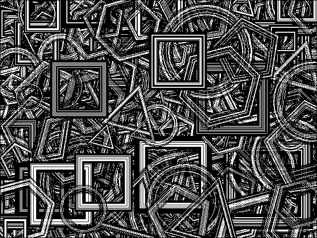

Black and White Infinite Art Cubism
MODE 1
 Q=Int(Rnd*5+3): If Q=7 Then Q=30
 A=Rad(360/Q): S=Sin(A): C=Cos(A)
 X=Rnd*MM.HRes: Y=Rnd*MM.VRes
 R=Rnd*(Sqr(Y+X)/20)*40+16
 For L=-R/5 To R/5
   N=(Abs(L)<R/8)*Int(Rnd*2)
   U=R+L: V=U
   X1=X+U: Y1=Y+V
   For I=1 To Q
     T=V*C-U*S: U=V*S+U*C: V=T
     X2=X+U: Y2=Y+V
     Line X1,Y1,X2,Y2,,N
     X1=X2: Y1=Y2
   Next
 Next
Loop While Inkey$=""

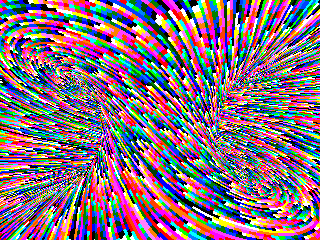

3D DISCO BALL
MODE 2
FRAMEBUFFER CREATE
FRAMEBUFFER WRITE F
 CLS
 t=Timer
 n=7
 r=n*16
 tr=t-n*50
 ra=tr/1234
 rb=tr/2345
 For a=0 To Pi Step .39268
   For b=0 To Pi*2 Step .8-.6*Sin(a)
     o=Sin(a)*Cos(b)
     k=Sin(a)*Sin(b)
     e=Cos(a)*Cos(ra)+k*Sin(ra)
     x=(o*Cos(rb)+e*Sin(rb))*r+160
     y=(e*Cos(rb)-o*Sin(rb))*r+120
     If Cos(a)*Sin(ra)-k*Cos(ra)<.05 Then
       C=Map(Int(Rnd*14)+1)
       Circle x,y,4,,,C,C
     Else
       Circle x,y,1,,,Map(15)
   Next b
 Next a
 FRAMEBUFFER COPY F,N,B

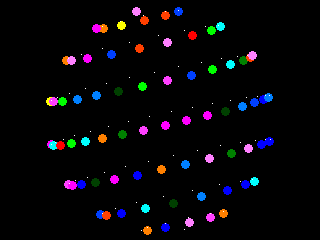

  Martin H. said  a litle animation inspired by the planet 9 demo
With small change it also runs on Game*Mite or any other Pico with LCD
FRAMEBUFFER create
FRAMEBUFFER write f
a=100:b=3:xc=160:yc=120
For n=0 To 9:For i=n To 180 Step 10
t=(i+90)*Pi/180:x=a*Cos(t):y=b*Sin(t):cl=(y<0):ball xc+x,n*20+yc+y-112,cl
Next : For i=170+n To n Step -10
t=(i-90)*Pi/180:x=a*Cos(t):y=b*Sin(t):cl=(y<0):ball xc+x,n*20+yc+y-112,cl
Next :Next
Blit 0,0,0,200,320,20:Blit 0,20,0,0,320,220:FRAMEBUFFER copy f,n:Pause 20

Posted: 05:16pm 28 Nov 2024
cool. needs mode 2 on hdmi pico 2. very fast animation, like 3d a bit!
Posted: 06:16pm 28 Nov 2024
3d disco ball rotataing x axis and y axis same time?? maybe?

  stanleyella said  3d disco ball rotataing x axis and y axis same time?? maybe?
Yes, its axis rotates in three directions, but the ball itself does not spin.

  stanleyella said  cool. needs mode 2 on hdmi pico 2. very fast animation, like 3d a bit!
Yes, Mode 2 was included in the original listing. The pseudo 3D visualisation was inspired by the old Amiga demos.
The slight offset when drawing the spheres results in the rotation that occurs when simply scrolling up
'no comment

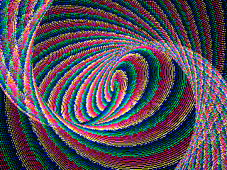

Attracting Star Whirlpool
MODE 2
Dim integer cm(15)=(0,14,0,7,0,0,6,0,0,4,0,0,2,0,0,0)
Colour Map cm(),cm()
Q=.375
For E=1 To 40 Step .025
 R=E*E/4:T=R/99
 s1=Sin(T):c1=Cos(T)
 N=5+R/1:A=-Pi*2/N
 S=Sin(A):C=Cos(A)
 X=0:Y=R:I=Rnd
 For L=0 To N
   I=I+1 And 15: If I=0 Then I=1
   Color Map(I)
   Pixel 160+X*c1*Q-Y*s1,120+X*s1*Q+Y*c1
   x1=X*C-Y*S:Y=X*S+Y*C:X=x1
 Next
Next
 T=cm(1)
 For i=1 To 15-1:cm(i)=cm(i+1):Next
 cm(15)=T
 For i=1 To 15:Map(i)=cm(i):Next
 Map Set
 Pause 50

Posted: 07:08pm 30 Nov 2024
nice one javavi
make it go in reverse maybe?
Edited 2024-12-01 05:41 by stanleyella

  stanleyella said  nice one javavi
MODE 2
Dim integer cm(15)=(0,1,2,3,4,5,6,7,8,9,10,11,12,13,14,15)

Posted: 09:08pm 30 Nov 2024
nice! is pico and mmbasic brill?
looks like star trek ds9 wormhole :)
Edited 2024-12-01 07:48 by stanleyella

Toroidal Reactor   ITER
MODE 2
Map Reset
For U=0 To 159
 x1=U/128-1.25
For V=0 To 239
 y1=V/128-1
   X=0:Y=X:Z=-2.4
     k1=Sqr(X*X+Z*Z)-2
     d1=1-Sqr(k1*k1+Y*Y)
     X=X+x1*d1:Y=Y+y1*d1:Z=Z+d1
   Loop Until d1<.005
   v1=Atn(Z/X):u1=Atn(Y/k1)
   sColor(): Pixel U,V
   v1=3.13-v1
   sColor(): Pixel 319-U,V
 Next
Next
Sub sColor()
 p=Sin(Int((u1+v1)*40)*99)*98
 c=15 And ((u1-v1+p)*24*Abs(Sin(p)))
 Color Map(c)
Dim integer cm(15)=(0,15,7,1,0,0,0,0,0,0,0,0,0,0,0,0)
 T=cm(1)
 cm(15)=T
 Map Set
 Pause 50
Edited 2024-12-02 04:09 by javavi
