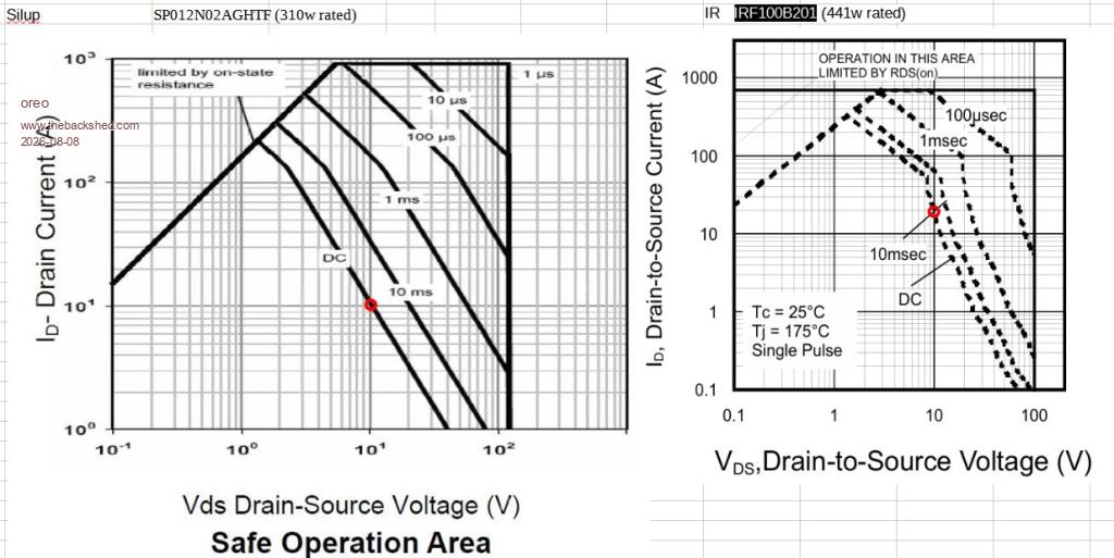

A tale of 2 mosfets

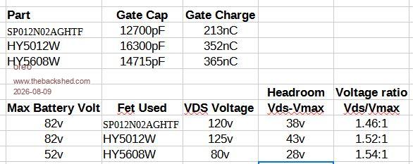

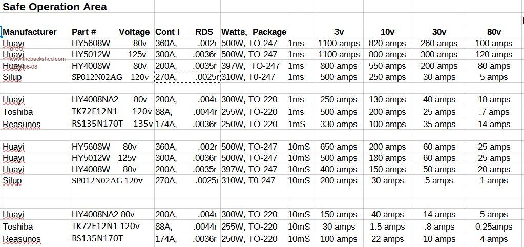

So, as mentioned earier, I have had an issue popping FETs.  Over time, I determined that the problem occurred when the load presented to the inverter, went over 7.5kw. This includes any surge. 7.5kw seems like a lot, but items like my AC unit draws 12kw on startup.
It was time to order some replacements, and up to this point I had been using the Siliup SP012N02AGHTFA.  I was using this part, mainly because the Huayi  HY5012W had been on backorder, and the Voltage/Max Current/RDS(on) on the Siliup part was similar. I reviewed the data sheets again, and noticed that the SOA curves for the Siliup part looked weird.  Although the part was rated at 310W, the DC curve showed the device could only withstand 10A at 10V Drain-Source which is 100w, not 310. Looking on the manufacturers website, the SP012N02AGHTFA has been replaced by the SP012N02AAGHTFA and the SOA curves look normal for this new device (at DC, the current x Voltage = device power rating. Anyway, after a bunch more searching, I found another device that had SOA curves like the Siliup part, the IR IRF100B201.  At dc and 10v, the graph indicates the part will withstand 20amps or 200w total, while the device is rated at 440w.
Maybe I am missing something, but I ordered the HY5012W's.  (note that the HY5608W will not work for me, as my battery voltage is 72V nominal)
While waiting for the parts, I looked at a huge number of SOA curves, and couldn't really find any devices that matched the Huayi parts.  Here is a chart showing a comparison of some of the numbers derived from the published curves for each device.

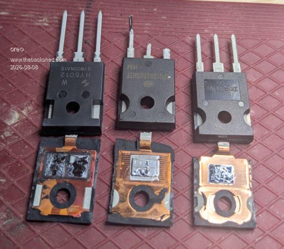

After the parts arrived, I popped the top off one of them to compare.
Yes, the HY5012W actually has 2 FET dies in there.  There are wires encapsulated in the plastic that connect each die to the outer pins.
Here is a comparison of surface area of the dies.
Looking at the specifications of other Huayi FETs, it looks like the 2 dies are from the HY3712B.  That is one way to get a superior FET without designing a new part!
So now I understand why the wiseguy inverter was underperforming with the Siliup Fets.  I still need to do some further testing, but for now I have raised the current limit.

Solar Mike
Joined: 08/02/2015
Posts: 1255
Posted: 08:05am 08 Aug 2026
Those points marked in red on the SOA curve are the steady state DC level, your mosfets are not permanently at that point on the SOA curve, they are or should be turned on in a few tens of nano-seconds, thusly the current capability increases as shown higher up the curves with decreasing on times.
Most likely it is a voltage spike thats killing them, 72v battery voltage, you need really 150v mosfets, perhaps the circuit requires the correct snubber RC network across the Drain\Source pins to control any voltage spike or ringing; look at it on a scope; generally the more current drawn the larger any ringing spikes.
Moving to compound die mosfets doubles the charge currents needed to switch them on in the shortest time, having 4 paralleled places a lot of extra stress on the mosfet driver and its bias supply, if the bias supply sags and cannot supply the required driver current then that will also blow them up, if you go for dual die versions, then a 2watt psu for the bias would be needed.
Thanks for the input Mike!  Can you tell me how you arrived at me needing 150v Mosfets?  I just linearly scaled up the 80v mosfets everyone else uses in the Wiseguy 48v inverter. (see calculations below)
While the gate capacitance of the HY5012 is higher than the HY5608, it does not seem to be that much different. (to me)  I show the numbers below.  I have checked the bias voltages in the past and will double check them again with the new FETs in there.
Edited 2026-08-09 03:54 by oreo

Solar Mike
Joined: 08/02/2015
Posts: 1255
Posted: 12:38am 09 Aug 2026
  oreo said  Thanks for the input Mike!  Can you tell me how you arrived at me needing 150v Mosfets?  I just linearly scaled up the 80v mosfets everyone else uses in the Wiseguy 48v inverter. (see calculations below)
From building numerous 1/2 bridge power circuits, some can generate quite high very short duration spikes, only picked up after looking on a scope trace, 72v base + a 40v spike is cutting it pretty fine using lower voltage mosfets. If you fire the thing up first at a lower voltage and spikes are low, then it would be safe to use a 120v device, or after measuring the ringing frequency and working out correct snubber values.
I always go for at least 30% margin in device selection, thus my estimate of 150v; the common ranges are 80, 100, 150v noting that some Chinese manufactures also have 120v devices. I did use some Chinese manufactured 120v rated mosfets in one PV controller and they kept blowing up, even after measuring within spec Drain\Source voltages, Swapping out for 150v devices, never had a problem, does make me wonder at times about the validity of some manufactures published spec's.

So I compared the power draw of the power board when idling using the Siliup devices compared to the Huayi devices, and only found about a .1w difference.
The bias voltages looked to be good, and then I realized that I was using 2w power supplies, so I have plenty of power supply wattage there.
Then I measured the avalanch voltage for both the Siliup and Huayi devices.
The Siliup devices (rated at 120v) surprisingly avalanched at between 139 to 149v.  The Huayi devices avalanched quite repeatably at 128-129v (rated at 125v).
So all things equal, it would seem that if the issue is voltage alone, the Huayi devices are going to fail sooner than the Siliup devices.
