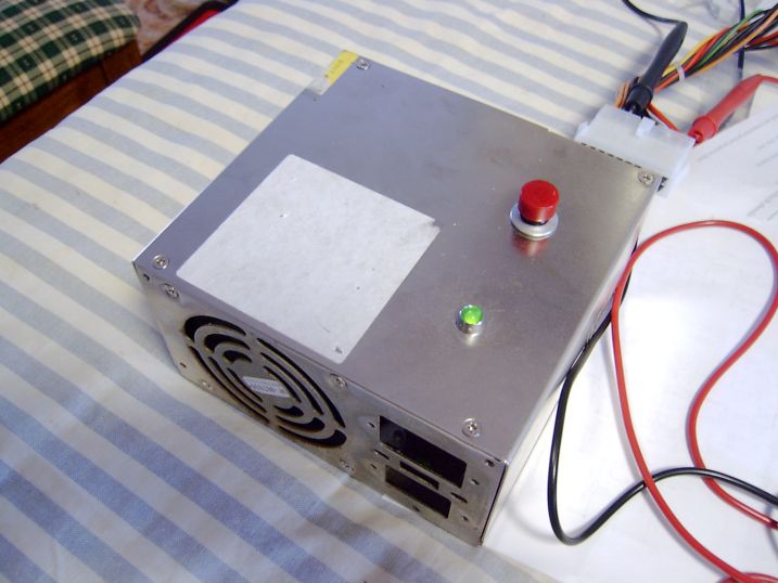

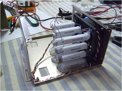

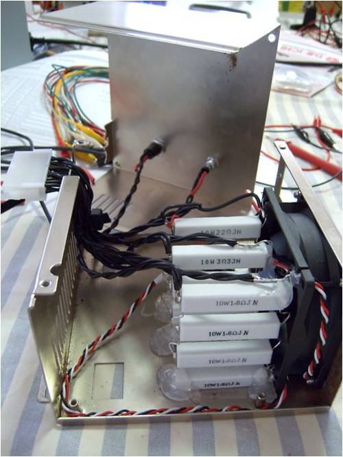

I was about to start poking a Yaha (Yeha more like it) ATX, It powered up and seemed OK with my ATX load tester on it, but I thought I'd just measure the rails & ripple before starting.
5V rail - 3.5V
12V rail - 8.5V
Not good. My ATX load tester just pulls the PWR_ON lead low and applies about 100W or so of resistive load to the 3.3, 5 & 12V rails. It does not measure the voltage or reject it if it is too low/high like a mobo would through its PWR_OK lead. Looks like I'll have to fit a few LCD volt meters to it. Or build V2.0 with PWR_OK LED as well.
So, upon testing several other ATX units I find the same thing. THUS why they were rejected! That'll teach me to check first. I've found a different brand working 600W victim, with nice big TO-247 package transistors and diodes! I'll poke around in that for a while
My ATX Tester V1.0:
sPuDd..
It should work ...in theory

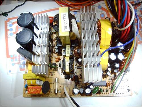

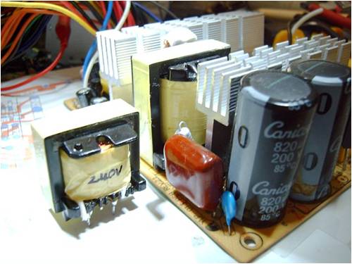

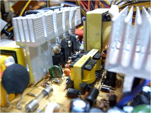

OK, new victim uses a custom made ATX IC WT7520 by Weltrend. It incorporates the comparator IC into itself. Unit claims to be a 600W PSU, Captain Spuddly will decide that after a good long soak test.
Its transformer is twice the size of the "400W" units. Has nice big TO-247 switching transistors. I think I'll make this one a 13.8Vdc unit. I added a 5k multi turn pot where the diagram shows in the example on the error amp input, and I could get about 13.3Vdc before the over volt shut it down. At least it works. I've started pulling all the O/P stuff out and tomorrow I'll set it up and correct the over and under volt inputs so they trigger at the new range. I think there is a spare input I can use for current limit/shutdown. Should make a nice 40amp PSU

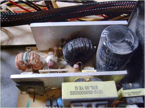

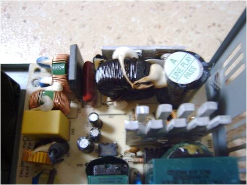

the 600W PSU is about a 2006 vintage. The IC spec sheet shows about a 2005 release date. Compared to the AT units, the ATX are better in all respects. More power for starters. Shake down your local computer repair shop.
One note - avoid any ATX that says "Power Factor Correction" on the side of it. All of those I've thus far found have tried to "Correct" a surge or dip and gone up in smoke. Plus it’s a lot of extra SMD rubbish on the front end you don't want to deal with.

[quote=Spudd]One note - avoid any ATX that says "Power Factor Correction" on the side of it.[/quote]
Spudd, I've only seen one PC powersupply that had powerfactor correction (PFC); it was a completely normal ATX supply, with the difference that it had a large choke in series with the input rectifier. There were no extra parts inside that PSU for PF correction apart from that large choke.
I removed it (was just taking up space and made working on the board harder) and ended up with a perfectly normal, easy to convert supply. The choke had the size of a small (50-75 W) transformer and accounted for much of the extra weight of the PSU. It wasn't mounted on the PCB but bolted to the metal casing. The extra weight (which I initially thought indicated oversized transformers, cooling fins, etc.) was what drew me to that PSU in the first place, but it turned out to be only caused by the useless PFC choke.
Maybe powerfactor correction has become smarter over time?
Your ATX dummyload looks pretty professional, btw. I just used a few H4 bulbs and a 12V/150W electric car heater as load....
(the upside of the lamps is that it also gives quite a bit of instantaneous feedback on what is happening to the power rails)

They seem to use an inductor (makes sense as the ATX is capacitive in nature) and seem to pulse it somehow with a MOSFET and some kind of correction IC, DIP or SMT. You'll see two well smoked inductors in these pics. I could stuff about and bypass it, but it's probably damaged the rest of the circuit.
Edit:
I've seen the ballast you speak of in another unit. I'd say that is Passive V's Active power factor correction.
End edit.

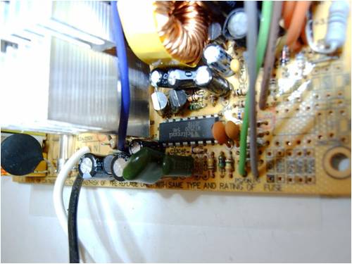

OK, finished playing with the 600W unit. The Weltrend ATX IC has its own drawbacks for modders.
There is no simple and gentle way of adding current limiting.
Having to preset all the over/under voltage comparators is a pain.
Does not seem to like running with less than ~50W load. It turns the whole IC on and off in a chattering mode when it can't minimise the duty cycle.
Never mind - it will donate its organs to another unit sometime. Pic of the mods:
