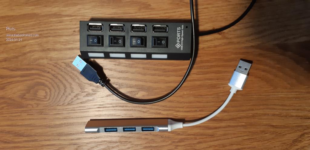

Firmware for swedish keyboard works!
BIG THANKS to NoOne!
This will make PicoMiteVGA so much more useful for me! It is a pleasure to immediately find the right keys at the correct positions without having to search and read small stickers on the keyboard.
I have tested with two different USB-hubs. The BLACK (USB 2.0)works, but the WHITE (USB 3.0) does not. This is not specific to the SWE keyboard firmware. It was the same for the previous firmware. The white delivers power so it is something else that make useless for this application.

Posted: 11:12am 21 Jan 2024
There is no text or info on the white hub. Ordered from Temu. White USB-hub.
This hub did not work!
It would be nice to see what is inside, but seems to be difficult to open without breaking it.
The hub that works (black) was easier to open. The chip inside is marked MW7211A IPA170251-1. It is a SOIC-16 package.

  Pluto said  There is no text or info on the white hub. Ordered from Temu
as a test, you may like to plug the hub into a normal PC, and into the hub plug two devices and ensure they both work.
on the eevblog forums there has been talk of various extremely cheap hubs that just have all four sockets connected directly in parallel. as a result the hub will appear to function with only one USB device plugged in, and also with multiple power-only devices (without DP or DM connection) plugged in.
rob   :-)

  Quote  as a test, you may like to plug the hub into a normal PC, and into the hub plug two devices and ensure they both work.
Tested the white module. Can at least operate 2 Picomites at the same time.

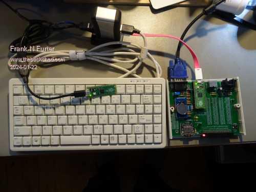

small success! I took a new board - now the LED lights up - but my keyboards still doesn't work!!!
I currently still have version 5.07.07b19 on the PicoMiteVGA. But that shouldn't matter?
Frank
P.S.: I found my mistake with the first board! I own about a dozen Raspberry Pi Picos and EXACTLY ONE Board with WLAN - and that's the board I accidentally used for the first attempt!!!!
But why is it still not working???
Edited 2024-01-22 00:57 by Frank N. Furter

Hi Pluto,
  Pluto said  There is no text or info on the white hub. Ordered from Temu. White USB-hub.
Pluto
I bought mine from Temu as well, it is easy to open, it is only fixed inside the case by the rubber end, flex it up and down and apply pressure outwards and it will pull the pcb and connectors out.
The chip in mine was a SL2.1s, it is USB3 in but only the end socket is usb3 out, the others are USB2

  Frank N. Furter said  But why is it still not working???
hi Frank,
   are you able to post a photo of your setup?
rob   :-)

  Quote  The chip in mine was a SL2.1s
Thanks for advice to open the hub. Mine is also the same.

Posted: 11:55am 22 Jan 2024
Hi Rob,
this is my setup:
The heartbeat LED flashes, the HID2CDC lights.
You can't see it so well, the HID2CDC is connected to the hub as a host via the USB-B cable.
If I connect the hub to the PC instead of the HID2CDC, I can access the PicoMiteVGA via TeraTerm and the keyboard then also works on the PC.
Frank
Edited 2024-01-22 21:57 by Frank N. Furter

hi Frank,
   where is power being fed in to? i can't quite see it in the photo, but i'm guessing it is only being fed into the USB hub?
rob   :-)

Posted: 12:26pm 22 Jan 2024
Yes, the hub is powered by a plug-in power supply unit.
I used to use this hub to successfully power Raspberry Pi I via the USB port, i.e. without an additional power supply unit. That always worked very well.
Frank
Posted: 12:50pm 22 Jan 2024
aha,
   i believe you will almost certainly need to feed 5-volts directly into VBUS (pin 40, ground return to pin 38) of the HID2CDC pico. while some power may appear to be coming out of the hub's HOST port, this will at best be coming from a pullup resistor somewhere and not be sufficient to keep the HID2CDC pico happy.
with many/some hubs, once the HID2CDC pico is powered directly the hub should not need power applied directly to it. having said this, i have one hub that will not operate in this way.
you could 'bodge' things by connecting a single flying wire from the 5v pin on one of the spare downstream USB sockets on the hub to VBUS on the HID2CDC pico, but i wouldn't really advise this.
rob   :-)
Edited 2024-01-22 22:51 by robert.rozee
