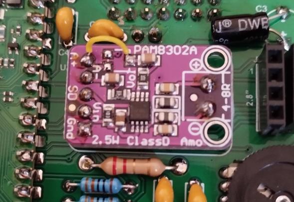

It shouldn't be relevant here, but a design note about the audio. It uses a PAM8302 mono differential amplifier, and the original intent was to use PLAY SOUND's MONO flag whereby GP19+GP20 would carry a mono signal and its inverse to A+ and A-. However after the first PCB (1.0.0) was laid out:
1. I realised that such a configuration would only work with PLAY SOUND, not PLAY MODFILE, PLAY WAV, etc.
2. Whilst playing on a breadboard I accidentally wired it up incorrectly and discovered you would get sufficient volume with A- tied to ground.
As a result the Game*Mite now mixes the standard PWM stereo signal through resistors and sends that to A+. We could have switched to a proper stereo PAM8403 but that module has a larger footprint and TBH you really don't need stereo sound for a device such as this - YMMV.

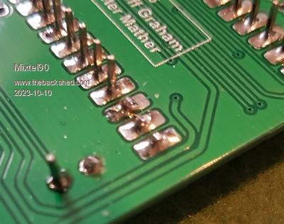

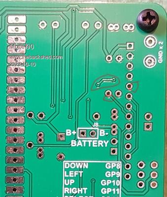

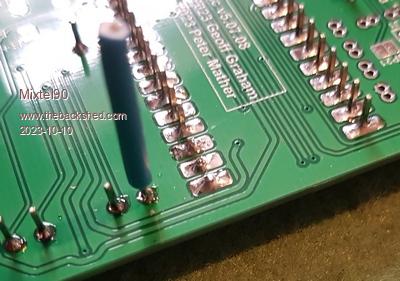

Oh, fun indeed! :)  Assembly went well - the instructions are good - but the debugging was "interesting" - and some of it was my own fault. :(
Lets get the nasty bit over first. I've highlighted three positions where there were shorts to GND on the PCB. Initially I thought there was a  bubble in the etching, but it turned out to be the gerbers that had the problem (after viewing them in SL6).
The top one was easy to spot, the two pad ones not easy to find at all because they looked deliberate. Note that the board in the photo is not the actual board but an earlier version which doesn't have the problem.

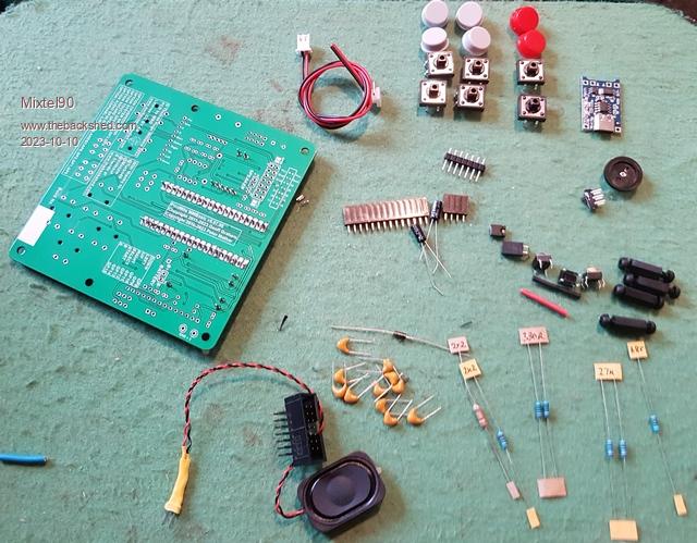

Right - the kit. I was pleased to see good packaging and antistatic bags used. Resistors had their values marked on them, which is great for those of us with less than perfect eyes or those for whom 4-band resistors are still confusing. :) At the bottom left you can see my "secret weapon", of which more shortly.
When trimming the male header pins be careful. They are hard (I suspect they may be plated and tinned steel rather than copper as they seem to be slightly magnetic). Don't use your best flush-cutters as you'll soon blunt them. You do need a flush cut though, so I'd recommend using old cutters or buying some cheap ones for the job. The bits fly off in all directions - you *need* eye protection. This is where my secret weapon comes in:
Put it onto the pin then snip below it. Pull the snipped bit out.
It's done. Nothing flies away (well, not often) and your fingers don't get bits of pin stuck in them.
And finally it's done. The battery is actually two free, reclaimed disposable vape batteries wired in parallel. (Link them in parallel but via a 10R or 12R resistor for a few hours to equalize their voltage before actually making the final connection). I replaced the spacers with 15mm ones to allow for the battery diameter. The 68R resistor is tacked onto the bottom - I had to pull it out during debugging and gave up on trying to put it back!

The bits I got wrong? Partially soldered joint on OUT+ of the charger module prevented running on battery. There was another dry joint too.

Hi Mixtel, All,
The problem was caused by an obscure bug in DEX,
With the 1.3.1 version I decided to try the option for curved traces instead of the usual orthogonal (45 and 90 degree bends) this was fine unfortunately I forgot to select TENTED VIAS, this means the vias were not covered by solder mask.
In the scheme of things it meant nothing and in fact only one via was visible once the PCB is built.
I decided to create Gerbers with the tented vias to pacify my (and Tom’s) OCD and our strive for perfection.
It seemed an easy task as all I did was check the box for tenting and recreate the Gerbers.
I always check them on one of the online Gerber viewers and I couldn’t see anything wrong and indeed I didn’t expect there to be anything different apart from the tenting so I didn’t check as thoroughly as I normally do.
Unfortunately something went awry, the design looked perfect on screen but the Gerbers that DEX created were flawed.
It was almost impossible to detect.
In any case I have changed back to orthogonal traces and refilled the copper pours and recreated the Gerbers with tented vias.
To not be trapped again with the faulty boards I have bumped the version number to 1.3.2, there is no electrical or physical difference to the non tented 1.3.1 boards.
