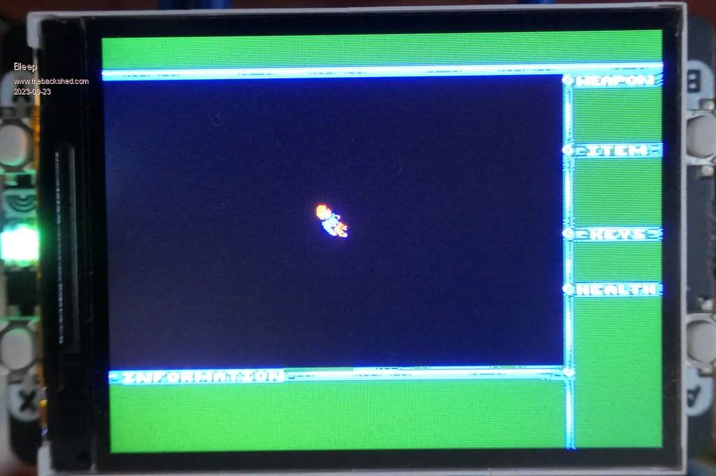

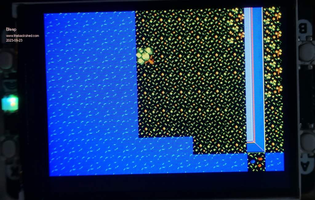

Hi Martin & Harm,
I have tested on a LCD display, this is the code I used.
'CSUB scroll test
'MODE 2
FRAMEBUFFER create
Dim LV$(64) Length 128
Open "Data\LEVEL-c" For input As #1
For f=0 To 63:LV$(f)=Input$(128,#1):Next
Close #1
'make an index file
create_index
'prepare screen
'path$="tiles\"
FRAMEBUFFER layer
FRAMEBUFFER write l
Load image "layer.bmp"
FRAMEBUFFER write f
ox=0:oy=32
For y=0 To 8
For x=0 To 12
 vl=Asc(Mid$(lv$(y+oy),ox+x+1,1))
 Blit compressed tile_index%(vl),x*24,y*24
Next
Next
FRAMEBUFFER write l
ox=13
x=0:oy=32
'scroll left
f=4:y=0:sn=0
FRAMEBUFFER write l
Blit compressed sprite_index%(4+sn),120,96
Inc sn:If sn=4 Then sn=0
FRAMEBUFFER write f
'Blit scroll -8,0
If f=7 Then
  'draw next column
  For y=0 To 8
    vl=Asc(Mid$(lv$(y+oy),ox,1))
    Blit compressed tile_index%(vl),264,y*24
  Next
  y=0:Inc ox:If ox>116 Then ox=1
  f=4
Inc f:Pause 75
FRAMEBUFFER copy l,f
FRAMEBUFFER copy f,n
No changes from here on.
This is Harms code as supplied in the zip a couple of posts back, but with a FRAMEBUFFER Create added to use in place of the N buffer.
First problem is that I have had to comment out the Blit scroll -8,0 because I get a syntax error? I don't think my display can be read from, but I though that was why the F buffer was being used?
Second problem is that transparency doesn't appear to work.
This is the image I get with the code as shown above, the little man is animated, otherwise nothing is moving, (not surprising as I've removed the scroll).
Just to be sure the tiles are loading ok, I reversed the frame buffercopy, to become.
FRAMEBUFFER copy f,l
FRAMEBUFFER copy l,n
Which gives:-
Now the strip of tiles on the Right are updating, but everything else is obliterated and static, no little man.
As is, with the Pause removed each frame is taking between 89 and 93mS at default cpu speed, 81 to 84mS at cpuspeed 252, as expected, the speed is limited by the display communications.
If I'm doing something wrong, let me know and I'll try again. :-)
Regards, Kevin.
Edited 2023-09-23 03:47 by Bleep

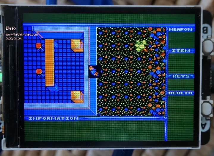

Bleep
Joined: 09/01/2022
Posts: 867
Posted: 09:15pm 22 Sep 2023
Hi Martin,
Have got it basically working, the only thing wrong is the moving character has a black background, everything else is as it should be, I hope.
'CSUB scroll test
FRAMEBUFFER create 'f
FRAMEBUFFER layer  'l
Close #1
'make an index file
create_index
'prepare screen
'path$="tiles\"
FRAMEBUFFER write f
ox=0:oy=32
For y=0 To 8
For x=0 To 12
Next
Next
ox=13
x=0:oy=32
'scroll left
f=4:y=0:sn=0
Do :Print Timer:Timer =0
FRAMEBUFFER write f
Blit 8,0,0,0,312,240
If f=7 Then
  'draw next column
  For y=0 To 8
  Next
  f=4
Inc f':Pause 75
FRAMEBUFFER Blit f,n,0,24,0,24,266,168
FRAMEBUFFER Write l
FRAMEBUFFER Blit l,n,120,96,120,96,24,24
Seems like a waste to use one whole frame buffer for the character, but I couldn't find a way of pasting him straight to the N buffer, everything else I tried, he would always leave a trail.
At 252MHz the update is about 130mS.
Regards Kevin.
Edited 2023-09-23 07:18 by Bleep

Martin H.
Joined: 04/06/2022
Posts: 1573
Posted: 09:42am 23 Sep 2023
Regards Kevin.
Kevin,
yes, thats why i asked for buffering the background of the Sprite before painting it. Restore the Background before scrolling.
so you dont need a extra Framebuffer for it.
change the Part in your code:
'we are on Framebuffer "F"
Inc f':Pause 75
'Buffer the Background
Blit read 10,120,96,24,24
'draw the Player
'copy all to Display
'restore the Background
Blit write 10,120,96
AFAIK the Blit compressed has no tranparency, so the Sprite will have a Black Background. Maybe in the Future it will extend it to boolean algebra, that one can AND a Mask and then OR the Sprite (something forthe Wishlist)
 Martin
Edited 2023-09-23 20:10 by Martin H.

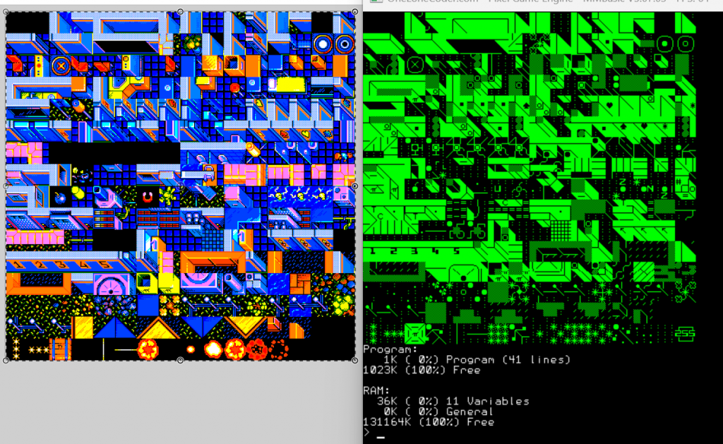

Joined: 04/06/2022
Posts: 1573
Posted: 03:42pm 23 Sep 2023
to whom it may concern
WIP
Imanaged to decode and display the PETSCII Tileset in MM Basic
Here is a comparison between the graphic tiles we use and the tiles, generated with the PETSCII (GFX Font).
(the 36 K Variables includes the Space for the LevelMap)
just for the case
Or transfere it later to other Mites
Edited 2023-09-24 01:47 by Martin H.
'no comment

Bleep
Joined: 09/01/2022
Posts: 867
Posted: 04:15pm 23 Sep 2023
Hi Martin,
Yes sorry I didn't quite see what you meant, the code example explained it.
All working now with only one frame buffer.
'scroll left
f=4:y=0:sn=0
If f=7 Then
  'draw next column
  For y=0 To 8
  Next
  f=4
Inc f':Pause 75
Blit read 1,120,96,24,24
'Draw the player
'Copy to the display
Blit write 1,120,96
Blit close 1
Unfortunately it hasn't really made any difference to the screen update rate, I'm now getting 128 to 130mS per screen update at 252MHz.

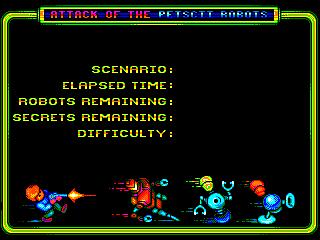

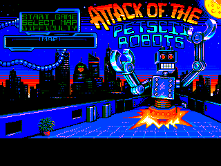

Martin H.
Joined: 04/06/2022
Posts: 1573
Posted: 09:00am 24 Sep 2023
Good Morning,
I converted / Repainted the next puzzle piece to Pico Colors for the Game
Intro screen:
I left the Space for Messages while Loading, Copyright etc.
End Screen:
Health phases (I already posted as CSUB)...
Have a nice Sunday
Mart!n
Edited 2023-09-24 19:10 by Martin H.
