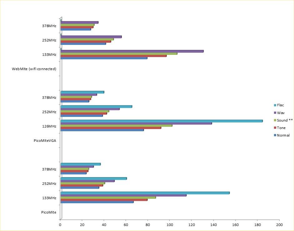

I've done detailed analysis of the overhead of using audio on running a CPU intensive program and these are the results. The number is the time taken in seconds to compute a solar eclipse over a period of 30 days
At 252MHz without audio the VGA version is 9.7% slower than the PicoMite and the WebMite is 18% slower.
Best case audio is a mono tone on the PicoMite at 378MHz which has just a 7.1% impact on performance.
Worst case is FLAC playback on the PicoMiteVGA at 126MHz which has a 143.8% impact.
        Normal    Tone**    Sound**    Wav      Flac
PicoMite
133MHz   66.04     78.70     86.33     114.23   153.58
252MHz   34.62     38.17     39.95      48.69    59.80
378MHz   23.06     24.69     25.39      29.70    36.00
PicoMiteVGA
126MHz   75.34     91.13    101.33     137.43   183.71
252MHz   37.98     41.75     43.69      53.27    64.70
378MHz   25.49     27.18     27.97      32.66    39.18
WebMite (wifi connected)
133MHz   78.58     96.06    105.90     129.84      *
252MHz   40.85     45.42     47.94      55.16      *
378MHz   27.15     29.36     30.25      33.90      *
* Not enough memory for flac and program
** Best case - mono output
Edited 2023-04-20 19:35 by matherp
