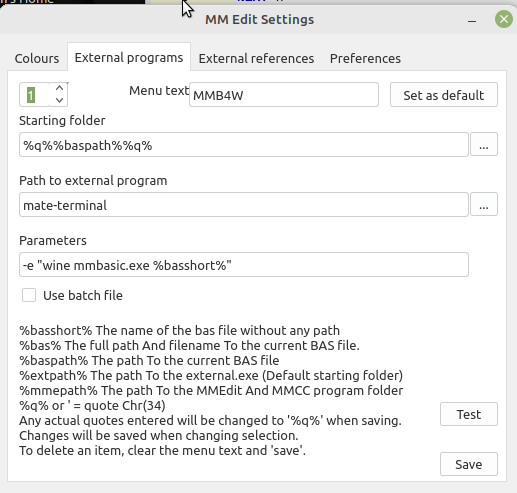

I have had some success with launching MMB4W under wine from the Linux version of MMEdit
(My Linux is worse than poor so beware)
wine can be run from a terminal.Your version of Wine is certain to be different to mine so these notes might not work.
On my Mint Mate the terminal is called "mate-terminal"
My settings in MMEdit preferences is:
Path to external program
mate-terminal
Parameters
-e "wine mmbasic.exe '/home/jim/.wine/drive_c/users/jim/My Documents/%basshort%'"
The -e causes wine to be executed when the terminal starts.
most terminal incarnations will accept -e I think.
I still have to sort out passing the commandline bas program.
MMB4W doesn't like the space in "My Documents" and I have not finished playing with quotes to see if I can solve it.
The other option is to put my BAS files somewhere in the Wine path that doesn't have bloody spaces. Downloads is a likely suspect.
For MMB4L I used.
-e mmb4l %q%%bas%%q%&disown

Doug,
Try this
In MMB4W, set the OPTION DEFAULT PATH to "My Documents"
In MMEdit set it to send the bas file name without any path.
Provided the bas file is in the default path folder, it 'should' work

Thanks very much Jim, all good - it was the link via the terminal that I could not get into my head,
Best Regards,
Doug.

Hi Jim,
With Cinnamon, it is gnome-terminal.
One thing that is a little annoying is that each time you hit the gear icon, you start up a new instance of MMB4W and its underlying console. You can get around this by closing MMB4W before starting a new upload but this is a bit clunky.
Is there any way that you can think of that would detect if MMB4W and its attendant terminal program are running? This would then require some mechanism of just uploading the .bas file.
Obviously, this is what MMCC does but I have not yet figured out how to connect MMCC to MMB4W running under wine on a linux system.
Cheers,
Doug.

With MMEdit and MMCC I use two methods. Windows can check for a running instance when you start a program and then pass the new command-line info by windows messaging before shutting down the new instance.
With Linux, I try and talk to it with TCPIP and if there is no response, I know to start a new instance of the program. This seems to be the safest way across multiple incarnations of Linux.
MMB4W doesn't cater for "only one instance" and I am not sure if it can be done.
Gerry disco4now created the MMEdit add-on MMReplace and it does talk directly to a running MMB4W successfully.
I think MMReplace is only for Windows.
If I get MMEdit to start trying to 'kill' other running programs, the AV program will not be happy with me.
If you want to get brutal, in a Linux terminal "wineserver -k" will kill ALL running wine applications.
A shell script can be started from MMEdit and you could kill all apps before starting the new MMB4W.
Brutal.
Posts: 6631
Posted: 04:44am 22 May 2023
Doug,
change your Parameters to:
--tab -e "wineserver -k" --tab -e %q%wine mmbasic.exe %basshort%%q%
It will kill any and all wine apps then run a new MMB4W.
Peter will rightly condemn me for suggesting anything other than a clean exit.
Edited 2023-05-22 14:46 by TassyJim
panky
Joined: 02/10/2012
Posts: 1136
Posted: 05:20am 22 May 2023
That's great Jim, works a treat,many thanks.
Doug.
