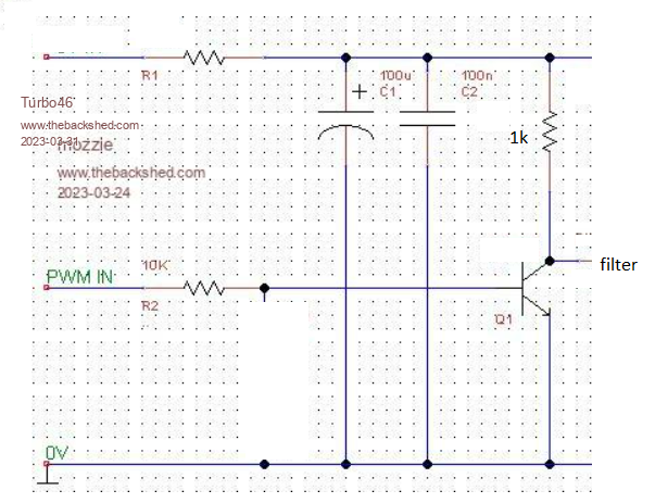

Volhout, I understand what you say. Maybe use 220R, LED, 820R then C1. It will reduce the volume a little more but that may be OK.
The transistor approach will still give the best results providing the noise is coming from the Pico. I am becoming more convinced of that but turning the volume down to zero should prove it.

  Quote  Use a switching transistor between the PWM output and the filter circuit. The supply for this switching circuit MUST be decoupled. Using the power supply for the amplifier will be OK. Any transistor 10k base resistor 1k collector resistor connected to the amplifier's decoupled supply, collector output to the filter.
I think I know what you want me to try, but could I suggest a snippet of schematic in case I don't .
As I understand it the switching transistor is the better alternative to adding an LED across C1 so I'll ignore the latter suggestion for the moment.
I also have a 2", 8R, 0.5W speaker that I will try later; currently it doesn't have any leads soldered to it so I couldn't just plug it in over breakfast.

Hi Tom, this is the best I can come up with for now. My ability to draw a proper schematic is limited for now.
It's part of a schematic posted by mozzie. R1, C1 and C2 are the existing filter for the amplifier and don't need to be duplicated.
The transistor will be switching from a relatively quiet supply unlike the 'noisy' Pico supply so the resultant PWM should be relatively noise free.
