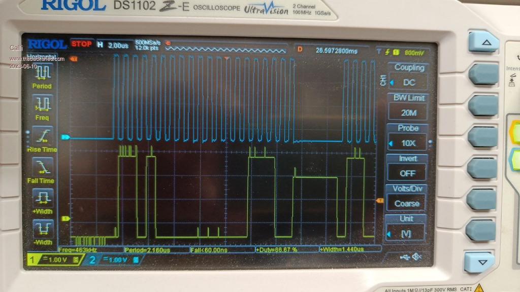

* I think all connections around the flash chip are ok, traced all out
* Clock... ok, I check, but I was thinking the RP2040 need to run to present me the Firmware update?
* Flash has power
Next I will poke a bit with the oscilloscope.
* Clock Xtal at 12MHz
C!
Edited 2023-06-10 01:17 by Calli
Calli
Joined: 20/10/2021
Posts: 74
Posted: 04:04pm 09 Jun 2023
* RP2040 gets a clock
* There is activity on the USB lines and I traced them ok
* I cant see a proper clock at the flash chip
* I can see some activity on DI of the flash when I reset.
Hmm clock and DI looks quite strange... Maybe they interfere...
(after Reset)
Need to look at a working board.

Posts: 9250
Posted: 04:18pm 09 Jun 2023
Often, when you see two different logic voltages above GND it means that a low is fighting a high and you are seeing a half-way level. It's not an analogue system AFAIK. Solder whisker on two pins?
Posts: 12074
Posted: 05:07pm 09 Jun 2023
I would guess at a short under the rp2040. You could try solderwick with flux all the way round the chip
