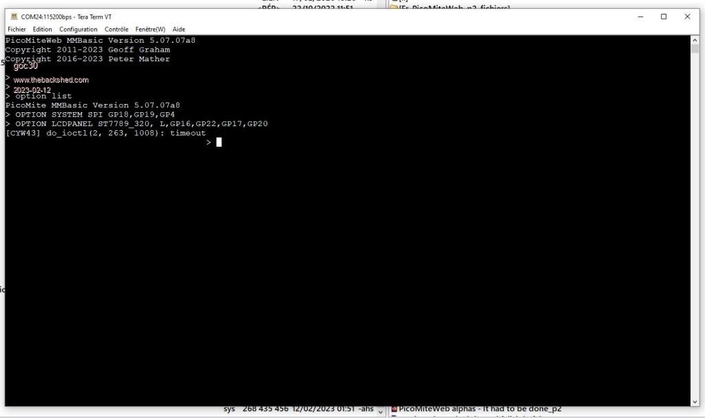

Someone tried to use picomiteweb with a Lcd panel (st7789 or ili9341)?.
At home, each time I declare the "LCDPANEL" option via terraterm, I receive a "time-out" message and nothing, keyboard blocked.
With "picomite" I have no pb with same options
OPTION CPUSPEED 48000
OPTION COLOURCODE ON
OPTION DISPLAY 49, 100
OPTION SYSTEM SPI GP18,GP19,GP4
OPTION SDCARD GP5
OPTION LCDPANEL ST7789_320, L,GP16,GP22,GP17,GP20
OPTION SYSTEM I2C GP0, GP1
I have to reload "clear flash" then picomiteweb. The problem exists whatever the version, whatever the SPI configuration, and either with the 2.0" display or with the waweshare restouch card
Edited 2023-02-12 04:04 by goc30

  Quote  At home, each time I declare the "LCDPANEL" option via terraterm, I receive a "time-out" message and nothing, keyboard blocked.
  Quote  OPTION CPUSPEED 48000
You are running the CPU too slowly. I'll block below 133MHz for the web version
Edited 2023-02-12 04:55 by matherp
goc30
Joined: 12/04/2017
Location: France
Posts: 435
Posted: 08:11pm 11 Feb 2023
no, the first thing i avoided was to change the speed of the cpu, because i know it can influence the operation of the card. the example quoted is just for info as a basic model
My configuration is minimal, SPI bus, LcdPanel, I2c, and nothing else concerning the hardware, and the problem comes just after the "System", SPI, I2C and LCDPANEL options (which causes the crash)
I can't even take a screenshot since everything is planted
Edited 2023-02-12 06:13 by goc30

  matherp said  V5.07.07a10
this is a screen capture of option setting
after "option lcdpanel", I receive an error msg, and it all folk!! nothing, nada, plus rien!
Edited 2023-02-12 14:14 by goc30

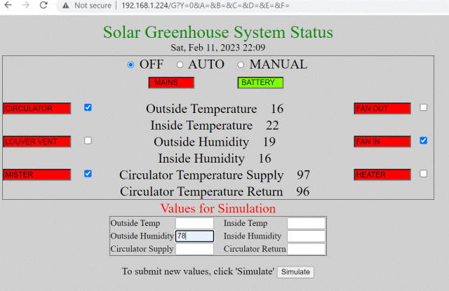

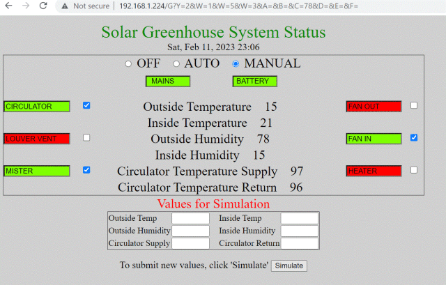

Posted: 04:28am 12 Feb 2023
I added 2 DS18B20 sensors, a 6-led module for the outputs, and a 4-button module for the inputs (SETPIN with DIN,PULLUP)--all with flying leads. Here is my hookup diagram:
V2.1 40-pin Picomite Pico_W controller
                             1 |             | 40 5V
                             2 |             | 39 5V
                         0V  3 |             | 38 0V
                             4 |             | 37
                             5 |             | 36 3V3
                             6 |  Picomite   | 35
                             7 |    I/O      | 34 Heater
                         0V  8 |             | 33 0V

If I depress the button for pin 20 (mains detected), check 3 of the boxes for outputs, before I click [Simulate] I get:
If I click "Manual", then release the button, put a value of "78" in for "Outside Humidity", and click [Simulate], I get this, with the MAINS box going from RED to GREEN:
All looking good for me so far. I have to add the input for the door and the output for lights to the HTML template file.
When you see " [CYW43] do_ioctl(2, 263, 1008): timeout  ", it is the error message from when the web server stopped.
You need to reset or power cycle the picomite, possibly a few times to get it back working.
