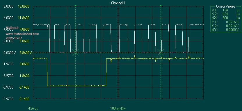

I have finally experienced the remark that Frank(N Further) made on the keyboard support. Not with his solar clock, but with the chess program.
I test this by pressing the NUM-LOCK key and check whether the LED turns ON and OFF.
I have not found a guaranteed way to reproduce it, it simply happens when the program is running. Could be working fine for few minutes, then simply no response anymore to the NUM-LOCK key. At that moment the keyboard is locked up for X time. Pressing <CTRL-C> can't stop the program anymore.
I started looking because I noticed that at a certain moment it looked like a different key was pressed (as if a glitch caused the bits to be shifted).
I tried hardware:
- waveforms are not different between working and non working keyboard. There are minor glitches, but these do not even come close to thresholds.
- I added 100pF and later 470pF capacitors to make sure the glitches where gone (but yes, that influences timing). To no effect.
- I changed the 4x10k to 4x3.3k for faster edges, no effect.
Is there anything I can do to help analyze ?
Attached is a scope picture of the original 1.4 board (with 10k pullups) on the 5V side. The PS2 clock is something like 16kHz.

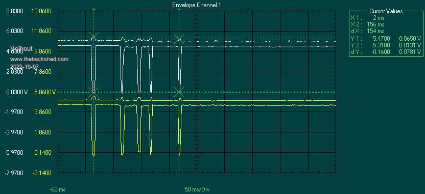

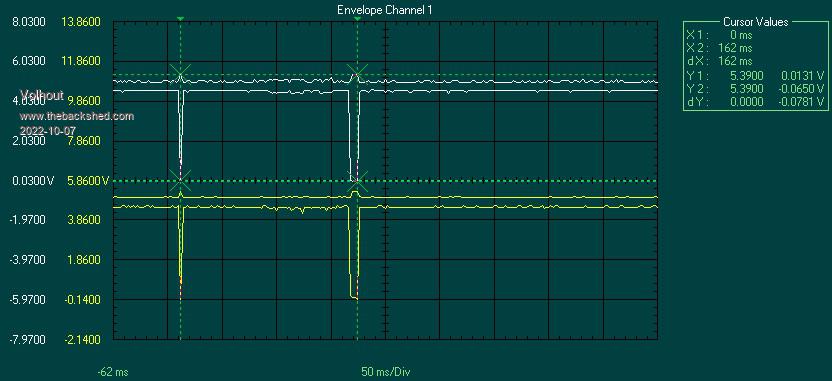

The 1/4 second low does not happen. Not with a working keyboard, not when the keyboard is not working. Maybe that is compromised by the OC...
In below pictures, the trace "envelope" is shows. My scope cannot show the detail in this timebase setting. Each peak is basically a set of clock pulses/data.
You can see that the working keyboard (numlock working) has a set of 5 communication packets. But no CLOCK low 1/4 sec.
When the keyboard stops working, there are only 2 packets. In case the keyboard should generate the clocks..well..it does not...
Again, this is num lock behaviour, which is not the actual complaint, but a method to show it stops working.
