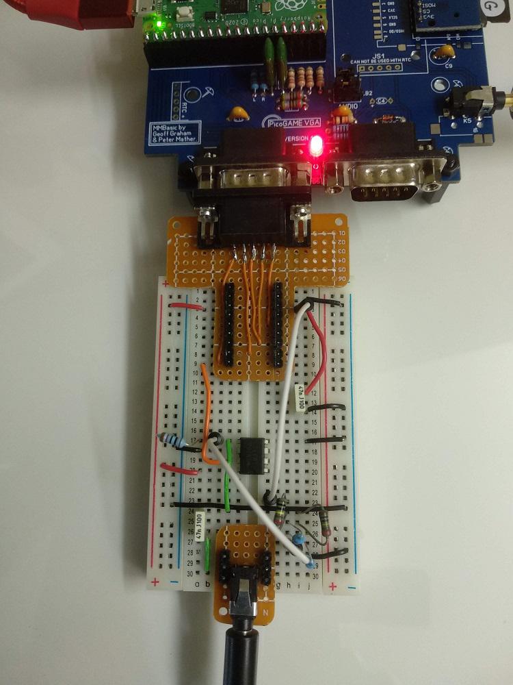

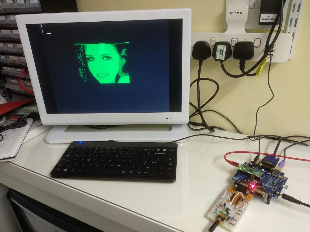

Successful test of @Volhout's entry!
As you can see my breadboard is "a bit how ya goin"; I was in a real rush to get it working and I had no 2.2M resistors hence the cluster of 4 (2x1M, 2x100K) in the bottom right.
The little adapter boards are made of the the very grottiest Chinese perfboard and I was soldering half-blind ... haven't done anything intricate in a while ... so off to the opticians this week for stronger varifocals I think.
Thanks for the entertainment @Volhout, all three judges agreed it's very impressive ... and that it doesn't fit the eligibility criteria for the challenge ; we may need to think about how to adjust those for 2023. If it is any compensation then I still intend to include it when I make the YouTube video for the challenge.

Tom, this sort of thing is very useful. Mine is more basic, no extra lenses and no LED. I don't solder without it.

Competition entry or not, I think this is a pretty amazing system. I really wasn't expecting to ever see SSTV running on a 4-quid microcontroller module and a comparator. :)

QUERY: I note that the most recent schematic that you posted contains an extra 47nF capacitor compared with the original entry, but that there appears to be a X marked on it on the schematic. What's that all about ? - I included it in my build.
OBSERVATION: Unless it got somehow mangled in the transfer the .bas file that you submitted isn't actually valid MMBasic, it splits the declaration of DIM a%(7) over two lines - obviously it was easy for me to fix.

The extra capacitor is a precaution to prevent the IC from oscillation.
In the VGA picomite it was not needed
In my adapter for K8 it was not needed.
But you where going to wire up something yourself, and I could not be sure that you would use long wires. With long wires, the IC has potential to oscillate. With the capacitor at the 3.3V and GND terminals this is unlikely.

But you were going to wire up something yourself, and I could not be sure that you wouldn't use long wires. With long wires, the IC has potential to oscillate. With the capacitor at the 3.3V and GND terminals this is unlikely.
OK, thanks, note that whilst you keep refering to K8 I think you mean K6 (Game port A) ... as far as I can tell the 1.4 PCB has does not have a K8.
