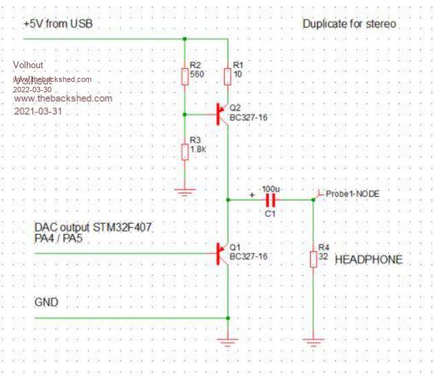

For those who are not interested anymore. This is the final circuit I published here in March 2021.
Amplifier
It does not use the resistor (27 ohm) but a current source for improved linearity. That also gives the advantage that the voltage at the micro pin never exceeds 3.5V.
Schematics:
Edited 2022-03-30 00:22 by Volhout
Posts: 9253
Posted: 02:39pm 29 Mar 2022
Once again the voltage on the micro pin is less than 3.6v *if the pin is either high or low*. It's still about 4V7 if the pin is tristate. If you put a 1k8 resistor from the PWM pin to ground the above circuit should be safe as the voltage is about 3V6. 1K5 would be safer still. Alternatively, put a small signal Schottky diode from the PWM pin up to 3V3 as the RP2040 hasn't got one.
IMHO this is important. If the pin isn't allocated to something to give it a high or low default then you run the risk of damage.
Of course, this isn't an issue if the pin is 5V capable, but unfortunately the Pico hasn't got any of those.

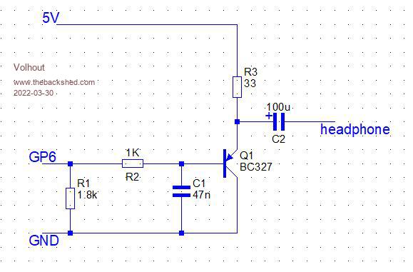

Posts: 6200
Posted: 11:33am 30 Mar 2022
So MIck,
If I understand you correctly, this would have your blessing:
Posts: 9253
Posted: 02:33pm 30 Mar 2022
Can't see why not - I'd be quite happy to use this. I might do, actually. :)
The 1k8 resistor could probably be higher in this circuit for safety, although you can usefully use it to set the bias current.
EDIT:
I see you might have set the bias. :)  It runs nicely in simulation.

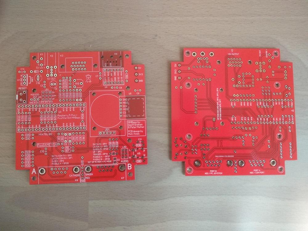

Posted: 03:49pm 06 Apr 2022
Looking at the photo of the boards, doesn’t look like any of the holes for K4 (PS/2) are plated thru. Looks like the circuits are on the bottom side, so probably works fine electrically. For mechanical strength of connector mounting, plated thru holes are better.
Posted: 04:01pm 06 Apr 2022
  al18 said  Looking at the photo of the boards, doesn’t look like any of the holes for K4 (PS/2) are plated thru. Looks like the circuits are on the bottom side, so probably works fine electrically. For mechanical strength of connector mounting, plated thru holes are better.
You are correct they are not plated through, there are a couple of non-plated holes on the audio jack too. No big deal, I'm sure that Mick will fix (unless deliberate) them with a Revision 1.1 before I order more boards .
Edited 2022-04-07 02:09 by thwill
al18
Joined: 06/07/2019
Posts: 252
Posted: 04:15pm 06 Apr 2022
I think the two nonplated holes for the audio jack were intensional - for mounting posts on the connector.
Posts: 9253
Posted: 04:18pm 06 Apr 2022
The PS/2 connector only needs pads on the bottom of the board. There are 3 large solder points there. If it bothers you, just bend the lugs before you solder. You'll probably need a hammer to get it off then. :) The through hole plating adds nothing to the physical strength - it's only microns thick and, even when filled with solder, can be ripped out. Likewise, pads on the top side can be pulled off the FR4. On the other hand, a soldered pad on the reverse side is bigger than the hole and helps a lot. The sources of strength for components mounted on a pcb are the fixing and alignment holes.
I couldn't guarantee that the PS/2 connections wouldn't *eventually* short onto the metalwork so all the tracks are underneath.
The reason it ended up like this is that originally I used the top groundplane as 3V3 and the bottom as GND. It makes life a lot easier when laying out a tight pcb, but you can't allow any metalwork to short out top and bottom, of course. Hence removing the top groundplane under the PS/2 socket, the reset button and the SDcard holder.
EDIT:
The audio jack has 2 non-PTH holes for alignment only.
Edited 2022-04-07 02:20 by Mixtel90
al18
Joined: 06/07/2019
Posts: 252
Posted: 05:38pm 06 Apr 2022
Mick,
Thanks for your design. But I strongly disagree with your statement
  Quote   The through hole plating adds nothing to the physical strength - it's only microns thick and, even when filled with solder, can be ripped out
I worked for decades as an engineer in PCB manufacturing and assembly. Pads on 1 side of the board are not strong - I’ve ripped off pads with too much heat during hand soldering. A plated thru hole with pads on both sides is very strong. While the copper plating in the hole is typically .001 inch thick and surface plating is .0015 to .002 inch thick, the combination acts like a rivet.
If I was building your board, I would as some 5 minute epoxy to hold the PS/2 connector to the board on the connector side.
Posts: 9253
Posted: 06:06pm 06 Apr 2022
YMMV, of course. :)

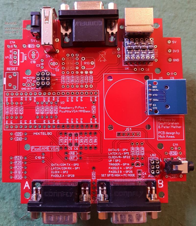

Posted: 10:47am 10 Apr 2022
PCBs have arrived, thanks very much Tom! :)  A lovely bright red. :)
Preliminary assembly tests - nothing soldered yet.
Audio jack location pins don't line up - just cut them off. I couldn't find a proper drawing of this component and it's *very* hard to see black plastic against black plastic, never mind measure it, so it was half expected. The pins are fine.
Alternative source for the VGA and game port connectors is Toby Electronics.
VGA socket is their part number HL15S
9-pin connector part number is DMR09P
Prices are quite reasonable.
The USB-A connector needs the big pins bending very slightly to bring them in line with the front & rear little pins. Once that is done it fits ok.
I tried 3mm MF spacers for the joystick module but they don't fit - I made the PCB holes 2.8mm for 2.5mm dia threads. Even so, the one closest to C8 may not work as it's probably too close to the SDcard.
A 3mm LED will just fit between the game controller sockets.
Holes for the male link headers are a shade too small. Some may fit, most not. You could hard wire or use female headers with plug-in wire links on this version. Something to fix for the next revision!
