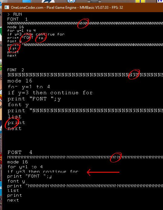

Matherp (or other gurus), I've had troubles running mode 16 - I get various corrupted characters on the screen. From what I've investigated, these corrupted characters are because the Window for MMB4W is not displaying a full 1920x1080 res and consequently the little bit of compression corrupts part of the screen. Mind you, the window fits exactly on my screen but MMB4W does not fill that window up (see left margin in the attached pic). Is this just my setup?
Posted: 10:07am 20 Feb 2022
  Quote  Is this just my setup?
Yes: sort of. You need a monitor resolution bigger than the mode you choose. My monitor is 4K and mode 16 works perfectly.

Thought that might be the case - no biggy
Posted: 11:55am 20 Feb 2022
I can create a mechanism to go full screen which will solve it - I'll include that in the next release

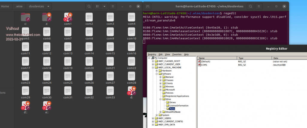

How to use serial ports in Linux when running MMB4W under Wine.
Tested on Ubuntu 20.04LTS (20.04.03).
- Install Wine (instructions from Ubuntu website, this does not install the latest version of Wine, but that is not essential for this post).
Most of us will use USB serial convertors using FTDI or CH340 chips. Good news: Linux does not require you to install specific drivers. All drivers (als for cheap chinese copies) are in the linux kernel.
Wine emulates windows in linux, and for serial ports it uses symbolic links to the linux serial ports. In linux these serial ports (devices) are visible as objects in the folder /dev/. The serial ports have a group identification (tty) extended with a type identification (i.e. S) and number (0...32).
The first serial port on a linux system would be /dev/ttyS0.
If you open a terminal in linux and type ls /dev/tty* you get an overview of all serial ports.
The type designator (the "S")  can have different types
S = hardware serial port
USB = USB-serial convertor (this type is used by FTDI chips)
ACM = USB modem (this type is often used by Arduino and the CH340 uses it also)
Linux automatically enumerates new serial ports when a USB-serial cable is plugged in. This is a convernience (easy) and an annoyance (2 USB serial ports are not always enumerated in the same order, so you can easily accidentally swap them).
Wine
Wine lives within the Linux system in the users space. In Ubuntu the user has a home folder, and in this folder you find folders like "Documents", "Downloads", etc.. very similar to Windows user space.
In this user space Wine uses a hidden folder called ".wine" (in Linux folders becomme hidden when the folder name starts with a period "."). You can view this folder in the file browser when enabling view of hidden folders (and then you will see many more hidden folders, but .wine is one of them once you have started wine once.
In user space the folder .wine/dosdevices shows the locations where Wine interfaces with the linux system. You can find a link to your C drive, and links to serial ports.
Every time you start Wine, the folder .wine/dosdevices is refreshed, so it is not advised to make changes to the links in this folder, they will get lost.
Wine re-writes the contents of this folder with links to serial ports in the /dev/ttyS* list, and these are defaulted to hardware serial ports (ttyS0...ttyS32).
It links COM1 to /dev/ttyS0, COM2 to /dev/ttyS1 etc...).
So how do we attach a USB serial port to MMB4W running under Wine...? All are attached to non existing hardware ports. Wine will add the /dev/ttyUSB0 after the first 32 hardware serial ports. so it will become COM33. When your program cannot handle COM33 (I expect MMB4W will, but some programs can not, they are restricted to COM1..COM4) then you need to force Wine to use the USB serial interface as COM1. This is how:
Regedit !
In the linux terminal, type regedit. You will start Wine's registry editor.
In HKEY_LOCAL_MACHINE/software/wine/ports you can find serial ports. This section is empty (only the default is there). When you add "COM1" with value "/dev/ttyUSB0" it will be replacing the default com1 link to /dev/ttyS0 to /dev/ttyUSB0.
See below picture that shows (in Ubuntu 20.04) the folder .win/dosdevices with many serial port links, and a link fopr the C drive. It shows the terminal where you start regeedit, and it shows an example in regedit, where I define the com1 link to /dev/ttyUSB0
For basic usage, when only 1 or 2 USB-serial interfaces are attached, this may suffice. You simply add a second entry in Regedit with com2 linking to /dev/ttyUSB1
For more complex setups, Linux can use rules, based on the manufacurer and serial number of the USB-serial convertor chip to identify each of them uniquely. When there is interest I can write a post about that.
So does it work .... YES
