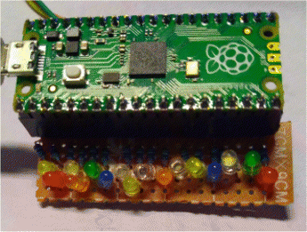

Here's a Picomite client accessed via serial (but otherwise following Geoff's example of the MX170 as an I2C slave in "A More Complex I2C Example" in the "Getting Started With the Micromite" guide).
I put LEDs on all the left side pins (I/O pins between the pin numbers 1 and 20).
Here's the picomite:
Here's a youtube video: Picomite serial client

I tested only digital out, but the code is also set up for AIN, DIN, FIN, PIN, CIN. I added DS18B20 support, but have not yet tested that. I also included code to allow basic statements to be run with EXECUTE when that command is provided on the Picomite.

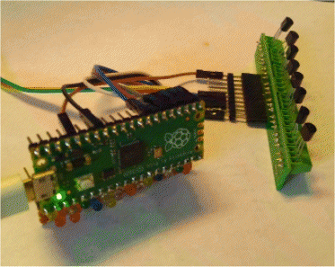

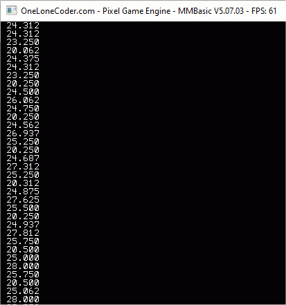

Posted: 03:42pm 25 Feb 2022
After some fiddling, this now gets readings from 4 DS18B20s on the client Picomite via serial:
dim integer i, p(4)=(0,24,25,26,27)
dim string s
font 1
open "com11:115200" as #1
for i=1 to 4:print #1,chr$(1)+chr$(p(i))+chr$(10)+chr$(13):pause 50:next
do
 for i=1 to 4
   print #1,chr$(3)+chr$(p(i))+chr$(10)+chr$(13):pause 100:line input #1,s: ?s
 next
 pause 2000
loop
