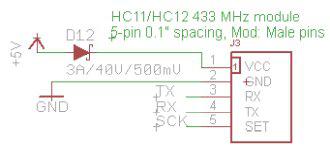

  Turbo46 said  What's next an HC-12 Module?
Seconding this. This might be easy to implement as not much board space required (module can hang offboard so only a 5-pin 0.1" connector required). Connections: 5V, GND, TX, RX, and optionally any available I/O for SET pin control (reuse RS485 DE pin as SET. Tradeoff is RS485 and HC12 both can't be used together so either one or the other)
I did this for HC12 on an Arduino:
SCK is any I/O but can be the RS485 DE pin (wouldn't use it as RS485 enable but treat it as a general output and manually toggle in code if needed).
The diode is for reducing Vcc to module if often transmitting but might not be needed if only occasionally transmitting.
No level conversion needed since micromite Pin 21(TX)/22(RX) are 5v tolerant.

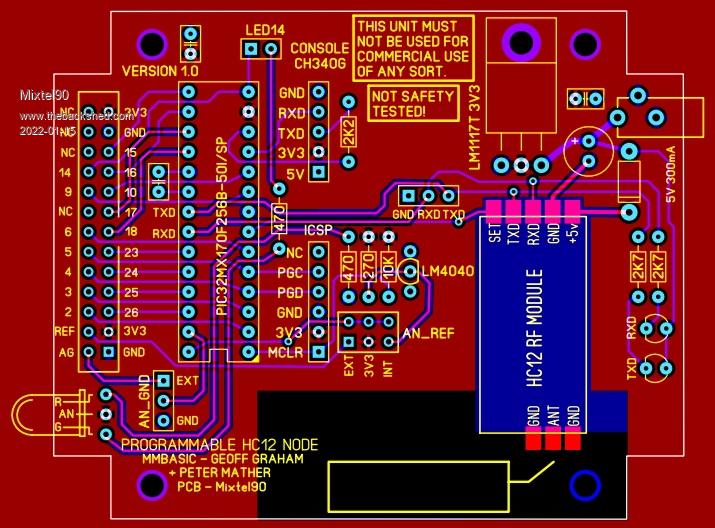

I'm doing ONE version to take the HC12 and the EY-40. That's it. I looked at the possibility of having the ESP8266-01S as well, but it got silly as I can't have any backplane close to the antenna on any of the versions, and adding more connectors means that some will end up underneath RF sensitive bits of others. PCB space is at a premium on both the SSD1963 adapter and the IO modules so that's it for the wireless types. I included the EY-40 as it raises the possibility of having an 8-port SMD module without the Micromite in it. Also, it's a local system, being at 2.4GHz.
Micromite HC12 node 10.zip
My idea for the last module in the series (as far as I'm concerned) will have a female connector on it and will plug directly into the male connector of any of the other modules. It will be another sea-of-holes unit so the user can add lights, switches etc. The already designed sea-of-holes unit can do a similar thing, but would be connected via ribbon cable so a few modules could be stacked vertically with all IO at the back.
Edited 2022-01-19 00:59 by Mixtel90

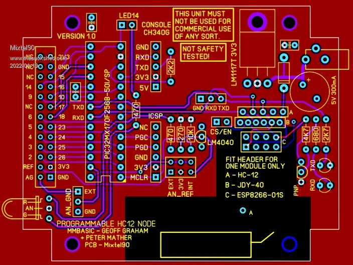

Posted: 08:04pm 18 Jan 2022
With added ESP goodness:
The ESP supply voltage is wrong, I know. :)
