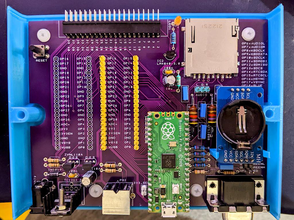

Here's my almost-complete build:
I've been designing my own 3d-printed case, as the Multicomp ones aren't all that easy to get here. It's almost entirely interchangeable with the original case. I'll release it when I've got one with proper cutouts for the ports

Nice build !
I like the purple board. Mine where "cheap" green...
But the combination with the blue casing is challenging !!
Welcome to the VGA club
Posted: 09:22am 02 Jan 2023
It looks great!

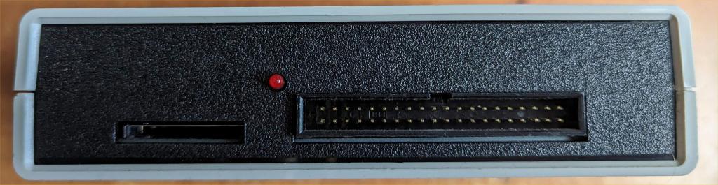

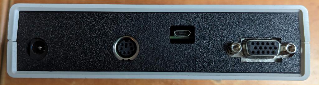

Attached dxf and the original Cambam design files for my end-plates.  As pictured these were cut with a LED laser
PicoMiteVGApanels.zip
You ain't seen the bright pink endplates yet!

  matherp said  Attached dxf and the original Cambam design files for my end-plates.
Much appreciated. Working out where the ports are supposed to live is harder than designing the case in OpenSCAD, so everything helps here.

  matherp said  Attached dxf and the original Cambam design files for my end-plates.  As pictured these were cut with a LED laser
Did you cut this on a Eleksmaker (like an A3 ?) or did you use more professional (higher power) cutter ?
I have one of these A3's and am still looking at how to use it best. It is quite accurate, but the laser itself is harder to focus for the real small stuff (PCB's). And it is only few watt. Maybe black plastic may work. Did not try that yet.

I use this although I've now upgraded it further with this laser module (I didn't pay that much!!!). Forget the 80W, it is actually two 7.5W laser diodes with the beams combined.
Hi Peter,
Sorry to be a pain (and probably a bit idle too) but I've successfully 3D printed cases for the PicomiteVGA (and having just acquired a CNC Router) I've just downloaded these DXF files to cut some aluminium panels.
However, I seem to have two front panel DXFs (the 40 pin end). I wonder if you could publish the back panel DXF again please.  :-)
