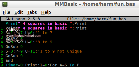

Posted: 07:39pm 29 Sep 2021
Yes, that solved the syntax highlighting. Copy and paste (^C and ^V) work now.
However saw 1 thing that intrigued.
Syntax highlighting is not perfect when line numbers are used...
When the line number is removed, highlighting works. See the top 2 lines of this basic listing. Also the second command on the line is not highlighted.
Maybe do not spend to much time on it. Nobody uses line numbers anymore...
Edited 2021-09-30 05:41 by Volhout
