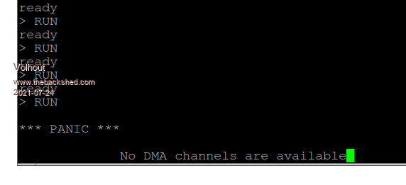

First test with ADC command.
I looked at Peters example code, and have created this program
' test ADC burst read
' connect ADC input to PWM output using RC filter to create triangle-ish wave
' PWM = 50Hz
' ADC takes 1024 samples, running at 50kHz
pwm_freq=50
samples=MM.HRes-1' 1023
adc_freq=pwm_freq*samples
gain=MM.VRes/3.3
'reserve memory
Dim array!(samples)
'open PWM(GP18) and ADC(GP26)
SetPin GP18,pwm1A
SetPin GP26,ain
ADC open adc_freq, 1, ready_int
'start PWM
PWM 1,pwm_freq,50   ' 50% = square wave
Pause 100
'start ADC
ADC start array!()
Do :Loop
End
Sub ready_int
 ADC close
 CLS
 For i=0 To samples-1
   'Print Str$(array!(i),2,2),
   Line i,gain*array!(i),i+1,gain*array!(i+1),1,RGB(yellow)
 Next i
 Print "ready"
 End
When I run this program it draws a square wave (with rounded edges if an RC filter is added, otherwise a nice square wave) on the LCD screen.
However, if I run the program several times after eachother, I get at PANIC error message. Not sure why, I do a ADC close in the interrupt, and an END (should close down the DMA's.
Posts: 12084
Posted: 09:20pm 23 Jul 2021
  Quote  However, if I run the program several times after eachother, I get at PANIC error message.
Thanks for the report - will fix in next beta

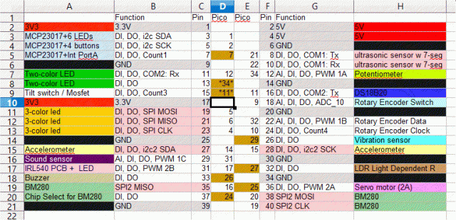

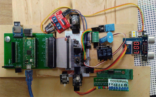

PicoMite PCB with 2x20 expansion PCB + modules
This is the same 2x20 board as shown previously for the F4 and CMM2, with a few wired modifications to fit the PicoMite PCB (mainly caused by fewer ADCs than on the F4 and CMM2, and some issues with PWM, and a desire not to take up 6-8 pins for an SPI LCD).
Here's the pin usage:
I used all of the Picomite pins, but had to reuse two of them to provide signals to all pins of the 2x20 connector. It was probably not a wise choice for flexibility, but I used pico pin 34 for both connector pins 12 and 13, and pin 11 for connector pins 15 and 16.

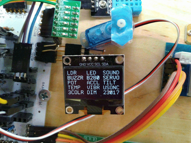

I wanted to retain a display for the module/device options, and use the rotary encoder to make choices. I used a 128x64 I2C SSD1306, with the option names reduced to 6 characters for the first column of 5, 5 characters for the second, and 6 for the third.
> option list
OPTION SYSTEM I2C GP10,GP11
OPTION LCDPANEL SSD1306I2C, LANDSCAPE
OPTION RTC AUTO ENABLED
OPTION GUI CONTROLS 59
OPTION MEMORY 60160, 100608
The second biggest change in the code was to "atomize" the performance of the module, to make it more like a state machine handling multiple modules simultaneously. I used SETTICK to extablish a 100ms minor tick, and 500ms for a major tick. The LEDs flash every 500ms, and the servo and PWMing changes occur every 100ms.
Here's what the menu looks like. Turning the rotary encoder causes the focus to change. The in-focus menu item will flash. If it has been selected by clicking the rotary encoder button, it will flash highlighted--black on white; if not selected, white on black.

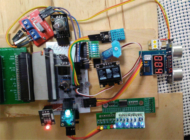

Pic with MCP23017 flashing lights, 3-color LED cycling through 8 states, red LED blinking on and off, and LED attached to the SPI1 port blinking:
Here's a youtube video which shows:
1) menu selection by rotary encoder shown on SSD1306 I2C LCD
2) 3-color LED
3) LED flashing
4) Buzzer
5) MCP23017 flashing 16 LEDs
6) Servo slewing from full clockwise to full counter-clockwise and back
7) PWMing of 5V LED using MOSFET module
8) Dimming/brightening of 5V LED using MOSFET module using potentiometer
9) ultrasonic distance measuring module using COM0
10) flashing of LEDs attached to SPI1 MISO, MOSI, CLK, and CS

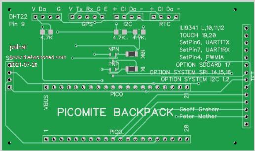

My humble Backpack offering, still needs a lot of checking.
