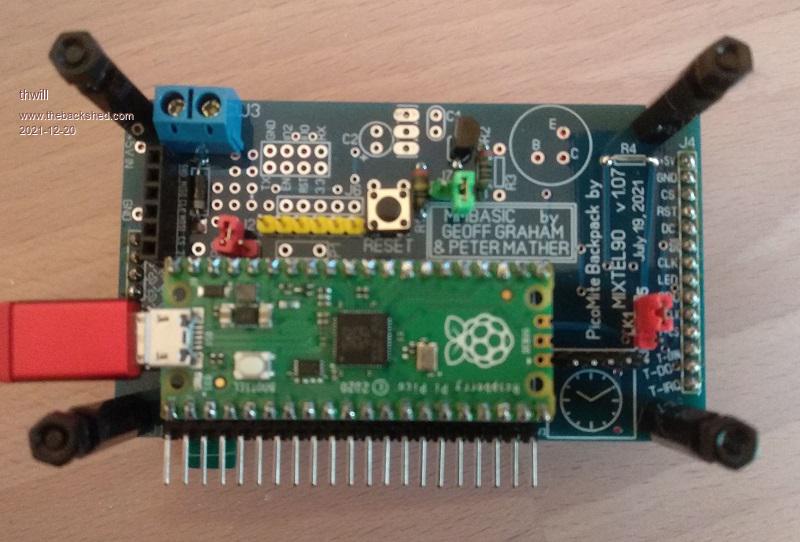

Posted: 12:18pm 20 Dec 2021
Hi Mick,
I'm looking at mounting a buzzer (9042 integrated passive piezo) to one of your backpacks, which currently looks like this:
From your manual I think I'm supposed to put it over the top-right circle that can alternatively have a transistor on it, which holes should it be soldered into, do I need any botch wires or does the PCB have the connections ?
The only other component I need is R3, correct ? This is supposed to be 560R which I don't have, would a 470R or 680R suffice or do I need to looking at bodging two resistors together in parallel or series to get something closer ?
I also have a couple of no-name, no-id larger 12mm buzzers (one active and one passive)  which I was wondering abut trying out. Can I safely try these and they will either work or not, or is there a danger of drawing too much current and releasing magic smoke ?
Thanks,
Posts: 9265
Posted: 12:51pm 20 Dec 2021
Your sounder goes between the points marked E and B in the circle, yes. If the sounder has a polarity then + goes to E. The value of R3 will depend on the type of sounder and how loud! The value isn't that critical.
Some of the passive pounders are basically a miniature loudspeaker and have quite a low coil resistance so they can draw a fair current. Something from 22R upwards might be an idea. Note that this sort have to be driven with PWM to produce a tone. If you are using one of these then remember that they are inductive. You should put a reversed diode across them as you would a relay.
Active / piezo devices have an on-board transistor oscillator and can only produce a single fixed frequency - but they do it very efficiently! They aren't inductive and draw a low current. They are either on or off so not suitable for PWM. Virtually all the piezo sounders are actually 5v devices but they usually work well at 3.3v. R3 isn't really needed with these and it can be a short circuit, but you can often add resistance to reduce the volume. There's nothing critical in any way, it's just that if the resistance is too high the sounder doesn't work. :)
It's worth testing before soldering anything. The 2N7000 is fairly rugged and very cheap. :)
Posted: 01:01pm 20 Dec 2021
  Mixtel90 said  ... If you are using one of these then remember that they are inductive. You should put a reversed diode across them as you would a relay.
Eee Mick you sound reet posh when you speak all foreign .
I think that maybe you're right, I'll try to find some time over the holiday period to smoke some transistors (I have a big bag) and buzzers (a smaller bag) separately from the backpack, though a Pico may still be asked to put its life on the line.
Posts: 9265
Posted: 01:23pm 20 Dec 2021
hehe....
The mosfet is, of course, merely a 3-legged fuse to protect the Pico. They are actually cheaper than proper semiconductor fuses and blow at about the same speed.  :)
The diode is an attempt to protect the 3-legged fuse...
