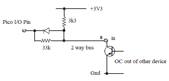

Posts: 3420
Posted: 01:41am 03 Jun 2021
Re no OC output state:-
Just put a schottky diode in series. Polarity depends on whether load is connected to + or -.
Re tristate leakage:-
If driving a transistor or FET put a bleed resistor from base / gate to ground.

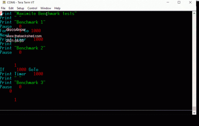

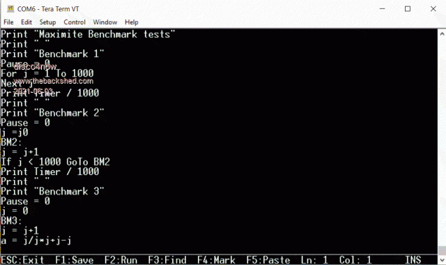

Posted: 06:27am 03 Jun 2021
Colours showing as BLACK in EDIT when OPTION COLOURCODE ON set.
Using TeraTerm certain colours are not visible/black in Teraterm. Teraterm with same settings is working on the F4.
The menu line along the bottom is not visible, normally a red colour I think.
e.g.
OPTION COLOURCODE OFF
F4 H7FotSF4xGT

As the Pico doesn't have OC output there is a chance, on a 2 way bus, the other device could go low while the Pico output is high. This circuit will provide protection.

  disco4now said  Colours showing as BLACK in EDIT when OPTION COLOURCODE ON set.
Try setting the Tera Term background to grey. I think you'll find that the bottom line stuff is black and isn't showing up on the black background. IIRC I had exactly the same problem with something else - it might have been the the F4.
It's pretty easy to tweak the TT colours.

  phil99 said  As the Pico doesn't have OC output there is a chance, on a 2 way bus, the other device could go low while the Pico output is high. This circuit will provide protection.
or you can play in software:
setpin x,dout
pin(x)=0
setpin x,din  'pin(x) is effectively OC
setpin x,dout 'pin(x) is low
setpin x,din  'pin(x) is effectively OC again
Edited 2021-06-03 17:54 by Mixtel90
