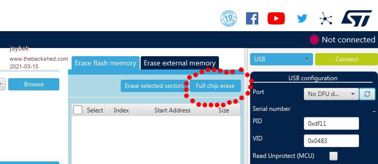

Posted: 02:20pm 14 Mar 2021
@RetroJoe.
I had the exact same errors with my board, as you describe.
I got it to run by pressing the "Full chip erase"-button in STM32CubeProgrammer, before uploading the firmware.
Hope it does the trick for you to.

@ jaybek, Thanks! I did try that at one point (I tried just about everything :), but it seemed to hang the STMCube app. I'll give it another go. What FW version are you using?
